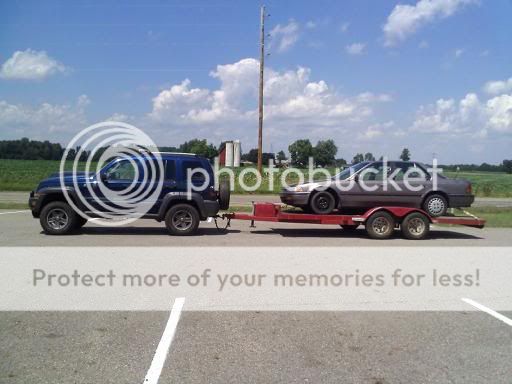

Had no problem going or stopping but the rear springs were about out of travel.
my only suggestion if you ever do it again, either roll the car back a bit on the trailer (granted the picture is at a bad angle but it looks like you got a foot or 2) or load it on backwards.
the car was on the other side of a ditch. I backed the trailer into the ditch for ez loading of a dead car. the only reason its not back further is because the ramps flip over onto the deck of the trailer and the way the braces were that was as far back as we could get it.
