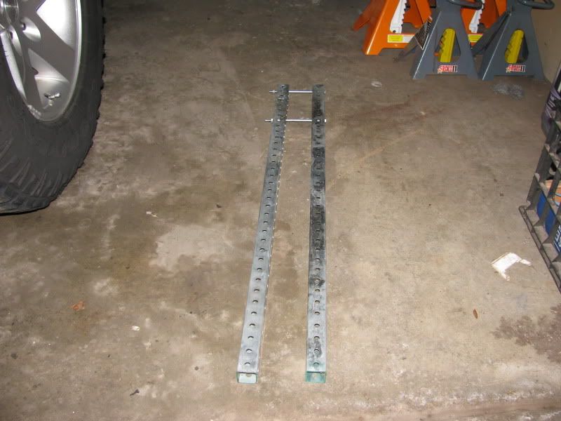

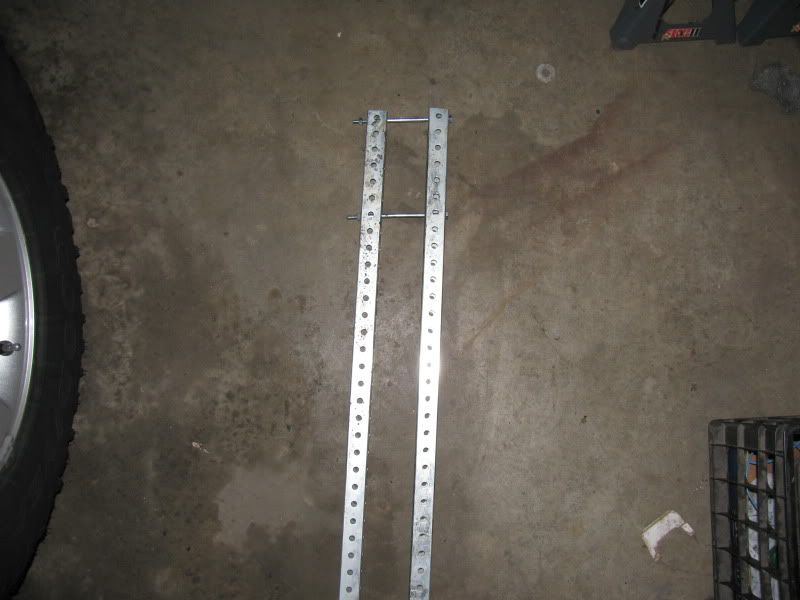

OK here it is, crude, homemade, shadetree but what I had laying around... main thing it works :wink:
