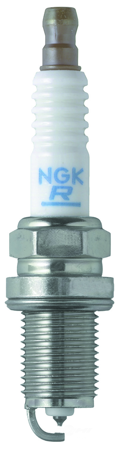

VTNomad wrote:
Yup, bought it new. The only time I've had it to the dealership was for the ball joint recall. I've done all the maintenance myself. I've been out of town for several months, but my wife hasn't driven it enough to warrant getting the oil changed. The only place they could have came from is the factory.
Couldn't find any marking of a brand or number or anything to ID them.
That's unusual. Mine were clearly labeled on the side.
Just like the ones in this pic.
2005 Blue KJ Renegade
PostPosted: Wed May 02, 2007 8:10 pm
Yep......those are what my plugs looked like also...except dirtier and worn out when I saw them.

 Post subject: Picture
PostPosted: Thu May 03, 2007 2:50 pm
Joined: Fri Jul 15, 2005 9:22 am
Posts: 421
Location: Salt Lake City, UT
This is what my plugs looked like, but without the markings.
2012 Jeep Wrangler Rubicon
 Post subject: Re: Picture
PostPosted: Thu May 03, 2007 3:00 pm
Posts: 503
Location: Richmond, CA
They probably aren't NGK's that came standard with the Liberty's. You said they were pretty clean? Mine after 32K looked well used.
