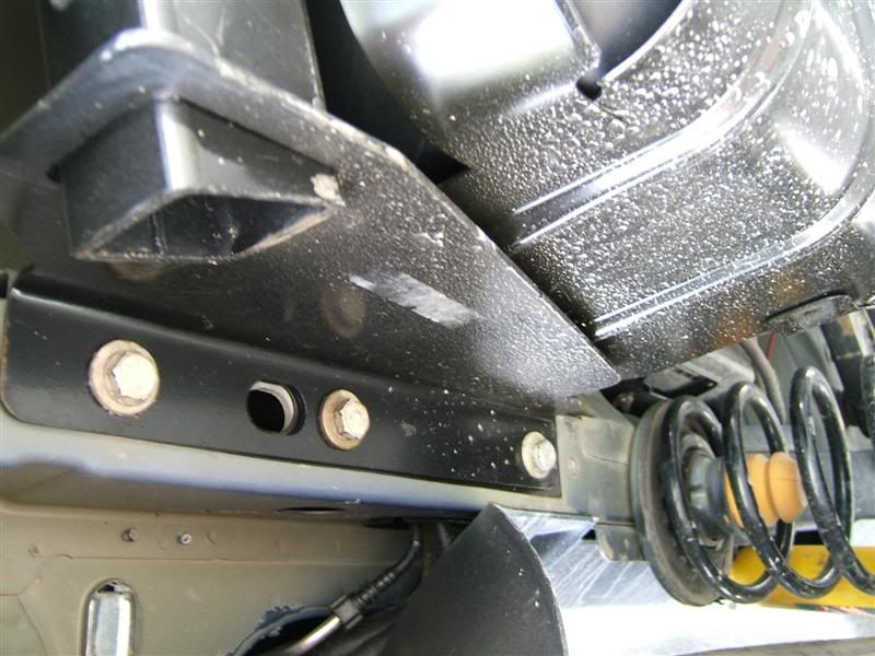

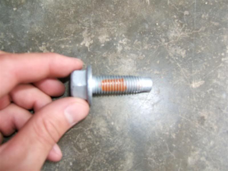

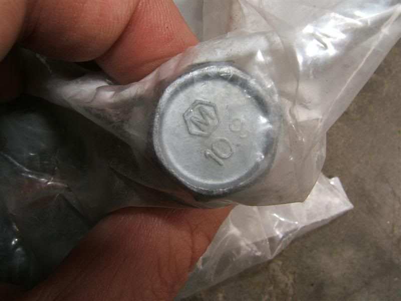

PostPosted: Fri Apr 07, 2006 2:13 pm
I dont remember anyone saying anything about giving you bolts. :wink:
Anyway, pics.
These are the bolts that came with my hitch, they look alot strong+bigger than the stock mopar bolts that came with my skid. So I used them instead of the mopar ones.
Heres what the bolts look like with the skid.
