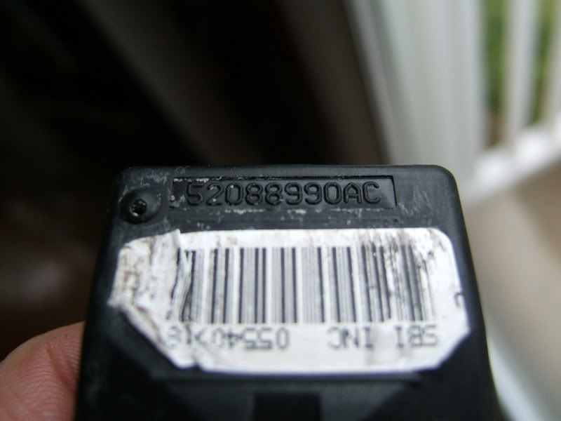

I found the part number for the sensors in the 04s, 52088990AC.
Each time I search parts stores they show that those are for the 300m. Has anyone purchased sensors for another set of rims?

You should be ok. That's the part number for the tpm sensors i have working with my '04 evic and rubicon rims.

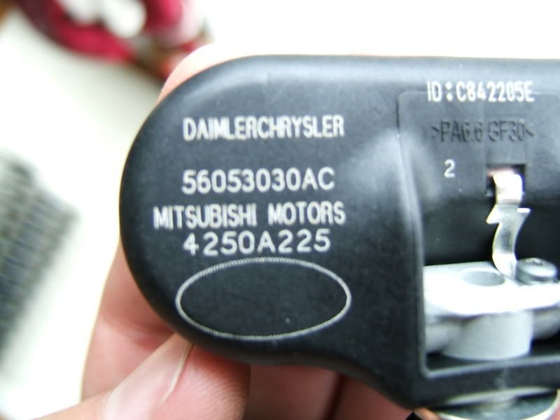

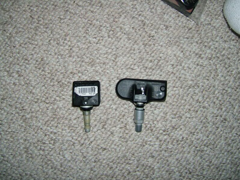

Meh-kick, make sure you get the correct sensors. They changed the type of sensor in 05.. I bought some off ebay for an 04-06 liberty only to find out 04 libertys use a different sensor than 05-06 libertys.
The one from my liberty is on the left and the one I got from ebay(05-06 libertys) is on the right.
Correct sensor:
Wrong sensor:
