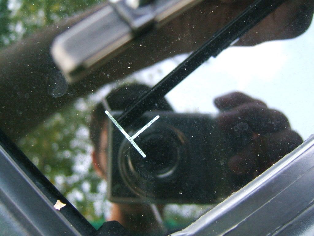

PostPosted: Wed Sep 26, 2007 3:56 pm
Take them off, sand them really good, and hit them with your primer and paint of choice.
To take them off, back the nut off but dont take it off. Use a small pair of channel locks and pop them off using the bottom of the arm and the nut.
Use the marks on the windshield to line the wiper back up.
Dude you must have like a 1000 G hard drive for all your pics!!! Thanks for all those. They've helped me a time or two!!!

Thanks so much guys. I appreciate the help, and especially the pics. What a great group!!
