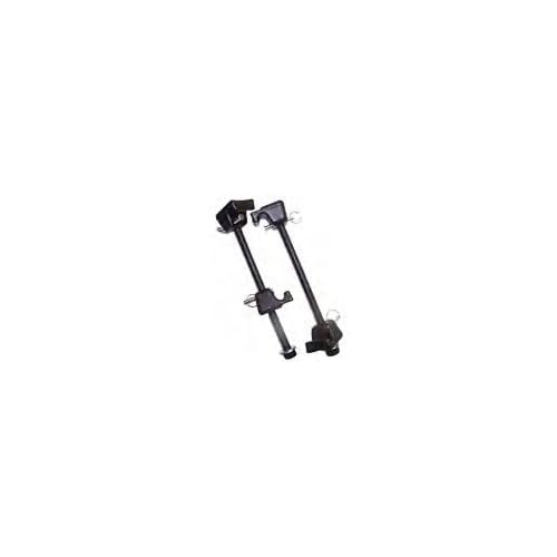

I picked up a pair at the auto parts store a couple years back for about 20 bucks. Look like this:
Dan

How well did they work?
I used a pair like that years ago, with out the locking pins, to TRY and change the springs on the struts on my '74 capri and they were a nightmare. a trip to the emergency room waiting to happen.

I've used them on an Integra and a friend has used them on a accord, which would be a much lighter spring rate. If there's major problems with using them, I'd love to hear it so I don't hurt myself when I do my springs :)

These are OME HD coils with OME struts compressed with NAPA McPherson strut heavy duty compressors. They have u-bolts that bolt directly around the coil. I taped the area of the coil that came into contact with the u-bolts to prevent the paint from rubbing off.
It took me quite a while because I just used the wrenches in the photo to crank the units, and bolting up the u-bolts and then unbolting them takes time too. In the photo it looks like the compressors are bent, but what's happening is the brackets are tipped slightly: the inside diameter of the bracket it slightly bigger than the diameter of the main bolt.
I feel these are very solid compressors and they did the job for me with one caveat: the u-bolts only allow the compressors to compress the springs to a certain extent, which turned out to be about half an inch shy of clearing the bolt on the strut. So I used two big bar clamps and compressed the last bit by clamping the entire coil/strut assembly.
It's up to you if you want to tackle this type of method. It's probably easier and not too expensive to get a shop to do it: I couldn't find anyone who wanted to do this for me, so I did it myself.

I tried a pair like that when I did my lift - and they compressed great - but once you put the top bolt on the assembly - there wasn't enough space to remove compressor from the coils - I had to take it back apart to get it out - ended up taking it to a tire shop that had a wall mounted unit - they charged $20 to compress things enough to bolt it together.
(I started with one of the ubolt types - it didn't work either - but remember the CRD coils are thicker, the spaces smaller)
GregScuba mentioned this over in another Thread
With the CRD model, you will absolutely need thin-jawed spring compressors since the coils are fatter and more numerous on a CRD. The ones they sell (not the rentals) at Advanced/Discount Auto Parts do the trick, are cheap enough, and are lifetime guaranteed. They are made by Ampro.

I bent the crap out of a pair of fairly heavy duty compressors the other day. I stopped because it was getting far too dangerous. The ones I were using also couldn't get both top hooks into the spring and the bottom had to be placed under the bottom "plate" of the strut assembly because they wouldn't fit in. Not cool, or even remotely safe!
Any ideas, please let me know. I am still waiting to get my clevis lift on because of this. I dont' want to take apart the whole front end again to do it.
Dan
Almost exactly what I used last weekend
Worked fine on mine (non CRD). I have used these for years on many different installs and never felt unsafe with them at all. Use them properly and follow the directions.
