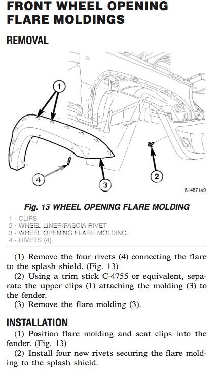

Here is what I have for the front:
I can cut and paste for the the rear as well if you would like, just let me know. This is just of of the service manual, so I don't know how helpful it will be. I used a couple of plastic bondo knives to slowly pry the fender flares off. The idea was to distribute the force to eliminate the possibility of marring the plastic flare, and avoid snapping the cheap plastic clips. I still broke a couple of clips, but you can get those from the dealer for a not so fair price.
