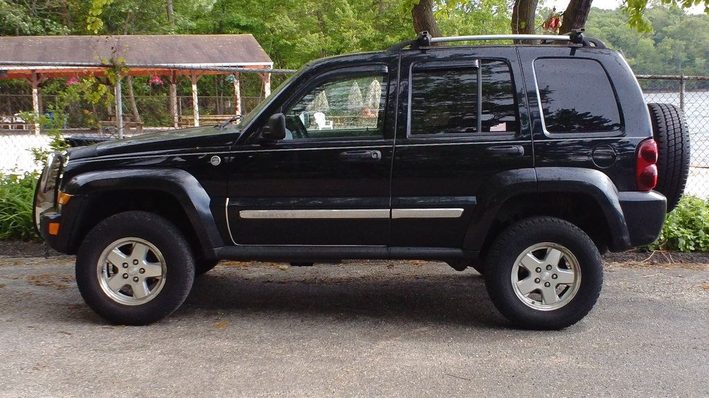

Results:
Rear coils (Moog 81041) are installed on the KJ (No spacer). Rear measurement from middle of center cap to fender turn in is 21.75", (the front is 21.5" with my previous front lift setup). I rode about 100 miles so far. It rides a little smoother that it used to, no driveshaft vibrations, and rear articulates much easier than the front (the front tends to stay more level over uneven surfaces). I drove over speed humps at 45mph (for testing purposes only) and the rear does not get propelled into the air as it used to, the vehicle lands relatively flat. I did not have to use a coil compressor or have to disconnect the rear swaybar but I did have to disconnect the bottom of the rear shocks to let the axle drop lower. I ran into an unexpected issue when installing, I had to trim the pigtail end of the Moog 81041 because it would not fit around the rear upper bumpstop cup. I cut 1/4 of a turn on the top coil pigtail. I'm digging this set-up for now and I'll report back if there are any issues down the road. I took lots of photos but am unable to paste the photos in this post.

Photos
http://s725.photobucket.com/user/rwfran ... og%2081041
[url]http://s725.photobucket.com/user/rwfranke/library/Jeep%20Liberty%20Moog%2081041[/[album]http://s725.photobucket.com/user/rwfranke/library/Jeep%20Liberty%20Moog%2081041[/album]url]

TYPO: (not 31.75 and 31.5). The current rear measurement from middle of center cap to fender turn in is 21.75", (the front is 21.5" with my current front lift setup). I don't know the stock measurements, has been lifted in one way or another for 5 years. I think the total lift is under 3 inches (not including tires).

3Dglasses wrote:
TYPO: (not 31.75 and 31.5). The current rear measurement from middle of center cap to fender turn in is 21.75", (the front is 21.5" with my previous front lift setup). I don't know the stock measurements, has been lifted in one way or another for 5 years. I think the total lift is under 3 inches (not including tires).
You have 2.5 inches of lift , same as you'd get from a full OME spring lift
Not enough room for your planned 265-75-16s
stick with 245-75-16s at most
