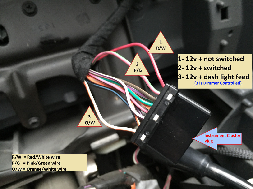

This is the connector to the back side of the instrument cluster panel on an 05 Jeep CRD with primary wiring circuits identified that can be used for installing gauges or switches.
The instrument cluster is very easy to R&R. :D

Thought about it some more: I'm going to seek out this elusive instrument panel wire because it will forever annoy me to have my switches illuminate with the interior lighting. But thanks for the info! I'm not sure it's the same for the 02-04 KJ's, but at least I can look for wire#3 and use that for switched+dimmed 12v. I'll keep you all posted.

Checked the instrument panel wiring: for early kJs it’s a solid orange wire that’s dimmed. Have to take off the bezel first but as mentioned earlier, easy removal. Throw a t-tap on the orange wire and you’re good to go.
