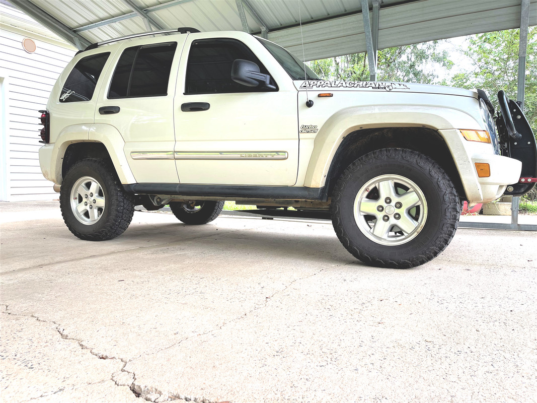

If you decide to install new springs, take a hard look at IronMan 4X4 Springs.
I have had them on my Liberty with a 0.5" clevis spacer for over 8 years now and they have held up very well with very little if any sag. :BANANA: See Picture below (w/ 245x75x16 tires).
They come with a 4 year warranty! :D
