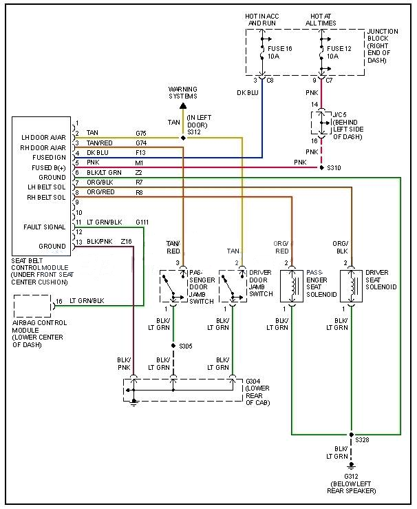

CaptainDean wrote:
1998 Dodge diesel seatbelts? They must be controlled by the body computer. Another version of AI that gets in the way without consideration of parts becoming obsolete. The old way of having a single wire and a light/buzzer for a non-operational part of the vehicle is better.
Hi Deen, No, it was not that simple. Wish it had been! :dizzy:
Actually it is a seat belt module mounted in a PITA to get to location under the center console/seat. See enclosed drawing
This module was some dumb engineers idea to automatically lock the seat belts in a full roll over condition. It had a steel ball inside the module that would roll over if the truck was inverted and make contacts to electrically lock the seat belt mechanisms.
The module was notorious for failing, so what does Mopar do, they quit supplying them, problem solved, NOT :banghead:
So when it failed, it locked the seat belt retractors all the time, you could not even pull them out of the retractors to use them at all.
So I had to devise a way to electrically fool/bypass the module. I figured out that if I soldered in jumper wire from the ign. (run/acc) wire to the two seatbelt solenoid wires at the module, it would allow me to pull the seat belts out and use them normally and the mechanical inertia lock would still function in the case of a sudden movement/jerk of the belt.
There should have been some kind of class action suit over this since it concerned a Safety device that was rendered unusable due to a faulty design and failed module.
