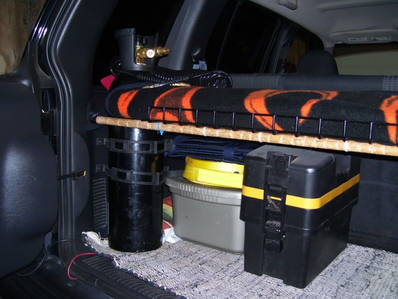

PostPosted: Fri May 15, 2009 3:44 pm
mine

Fulltimer wrote:
I know everybody can't do this setup but it may give someone some ideas. My tank is 25# and can produce 3,000lbs. pressure. It cost me $4.00 to have it filled.
Seriously dude wow, can i wheel with you :)
