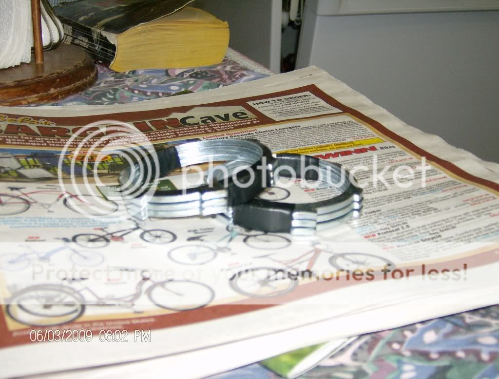

Got the first part of the lift today :lol:
Yea I know just a trip to the hardware store and back.... but I should be ordering the rest in the next couple weeks. And I guess their on back order for 4-6 weeks, so by August? Maybe September? At least it's before the snow "usually" flies.
PostPosted: Wed Jun 03, 2009 8:24 pm
Slick little trick taping them together :shock: :wink: :lol: :lol: :lol:

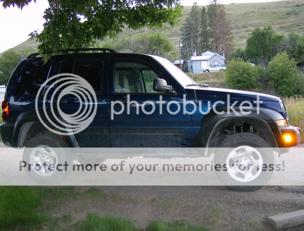

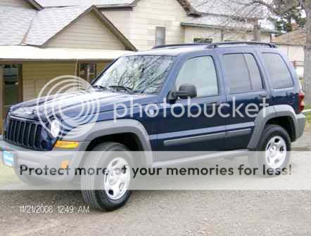

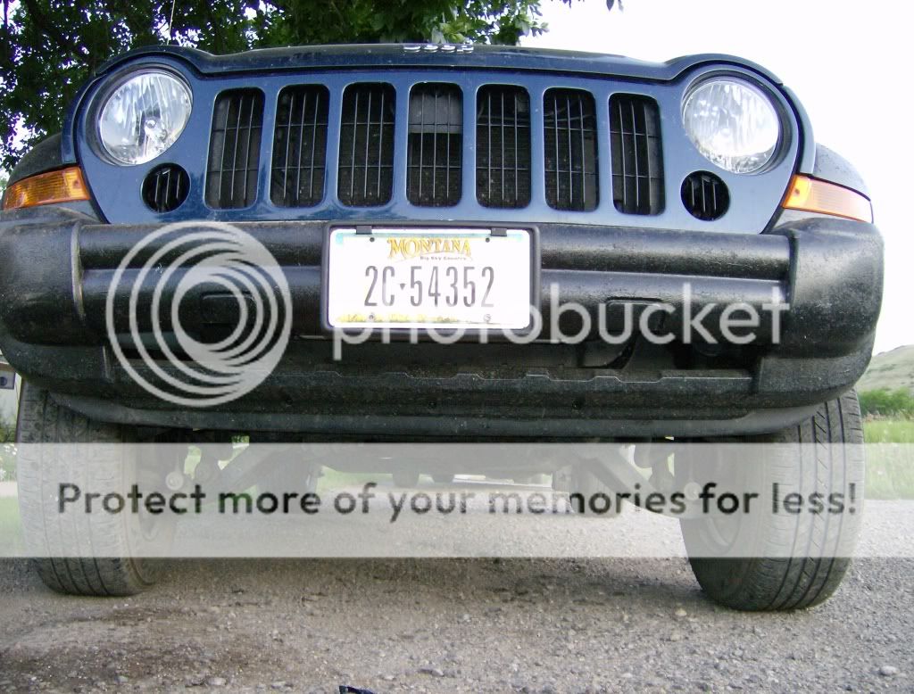

Ok guys I finally worked out all the little bugs, clunks (slightly tightened the bolt on the driver rear shock and poof gone.) I wanna throw a shout out to Rock Lizard and All J's for their support. And to everyone that helped me through this. For being a complete novice on the mechanical parts of a vehicle I was actually able to do this, but not without your help. Pics are below :D
Before:
After
