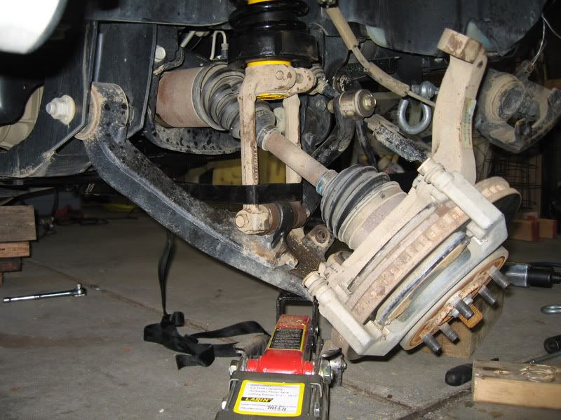

brasilrenegade wrote:
what is a clevis???
The tuning-fork looking device that comes down on either side of the front drive shaft in the picture below (the part that has the black strap wrapped around it) is the clevis. Thanks Miah for posting this nice pic in your Frankenlift install write-up.
