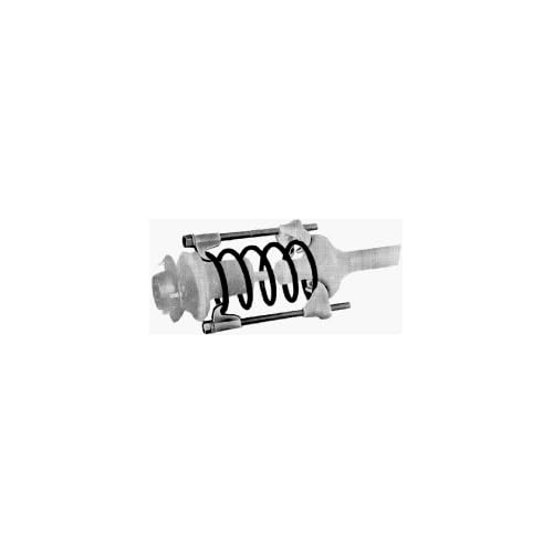

I was looking into lifting my kj soon and wanted to gather up the tools needed, I am going to go with the Daystar lift for some light off roading. I think the only two tools I need is the spring compressor and the ball joint seperated. I just wanted opinions on if these are suitible for the job from Harbor Frieght
$39.99
$9.99

that is one sweet spring compressor !
we used the claw type compressor when lift was installed. didnt need the bj seperator.

Pretty slick looking spring compressor I must say as well! I'm confused as to which way it squeezes?!! Looks like threading rods make it uhmmm...narrower in the picture but the hinge at the back would lead me to believe it gets "shorter"?...

I tried a spring compressor like the one in the 1st picture on the 1st post and it wouldn't fit the front strut springs. Ended up using the claw type one:

I tried a spring compressor like the one in the photo and it wouldn't fit the front strut springs. Ended up using the claw type one:
Yeah, the claws are to thick to remove compressor after you compress the spring.
