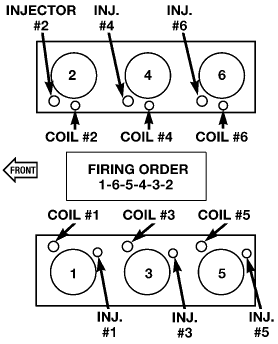

PostPosted: Tue Sep 16, 2008 11:06 pm
Joined: Wed May 17, 2006 8:07 am
Posts: 117
Location: Northwestern Alberta
Bought the reader, read "Cylinder 5 Misfire". Parked it for a couple days and cleared the code tonight. Drove it home with no problems. Seems to have dried out and solved itself. Probably saved about $200-$300.
Stupid question... Which cylinder is #5? Right front or left rear?

PostPosted: Wed Sep 17, 2008 9:24 pm
Joined: Fri Jun 06, 2008 11:40 pm
Posts: 630
Location: Southern New Jersey
Here you go this may help :D
