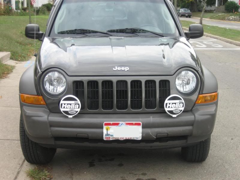

Should I get the Hella 500 Series lights for the front of my liberty???
And for mounting them, i have a drill and all, but how do i bolt it on from underneath??? seems like its hard to get to

i just got done mounting my hellas and they turned out great, what i did was take the front bumper cover off, and just to the inside of the frame end caps, i took a peiece of angle iron i cut about 2" wide and mounted them to the frame, (trashed the plastic support peice inside) and marked its center and reinstalled the bumper cover. then just drill a hole throgh the plastic bumper / angle iron and its very strong. forwarning if you do get them, the wiring diagram is a little bit confusing. all the colours are wrong
