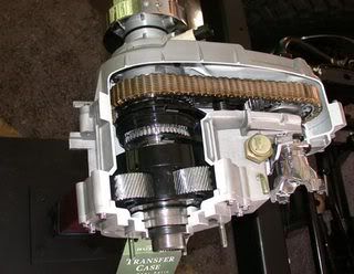

Here's what the innards of my new TC look like, in case anyone cares:
