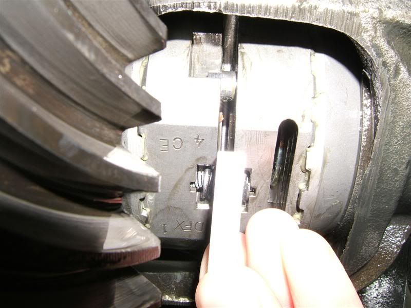

Ive got it in no problem. The spacer I have that came with the spring kit does not fit the gap that its supposed to. I bought the locker off a Lost member and he lost some of the springs so we ordered new springs from randys ring and pinion. The spacer is supposed to be the same that came with the locker. Its says if the spacer does not fit then my axle is messed up or something.
Another thing, in the end it says the wheels should be able to be spun by hand but not in the same Direction, mine do not do that. With the tranny in park I cannot spin anything, I thought that was how a locker was supposed to work? If I drive it Im afriad something is wronh and ill break an axle.

Pics of spacer:

Also, there seems to be alot of play in the locker. When I try to turn one wheel, one side of the locker moves alot and those springs in the pics move side to side. Is that normal?

Hey i called and just got a machine...The spacer block you have could be wrong. i know they shipped a few with the wrong spacer. if you look at it...It should fit turn one way but not fit turn the other... Hope that helps. Yes there will be some play form one side to the other...Not a problem at all. later...Clint

She works! i figured thats what it was with the spacer tool. I got on the fact section and saw his spacer tool and it looked alot smaller than mine.
