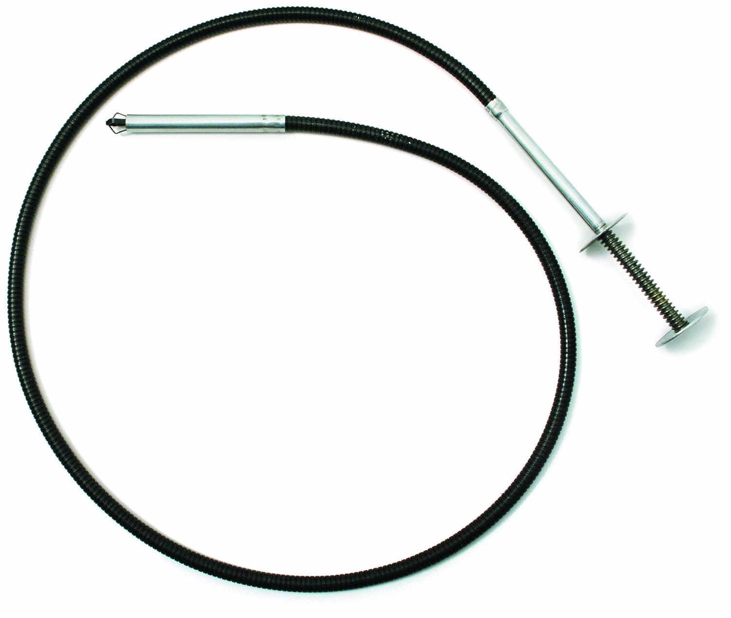

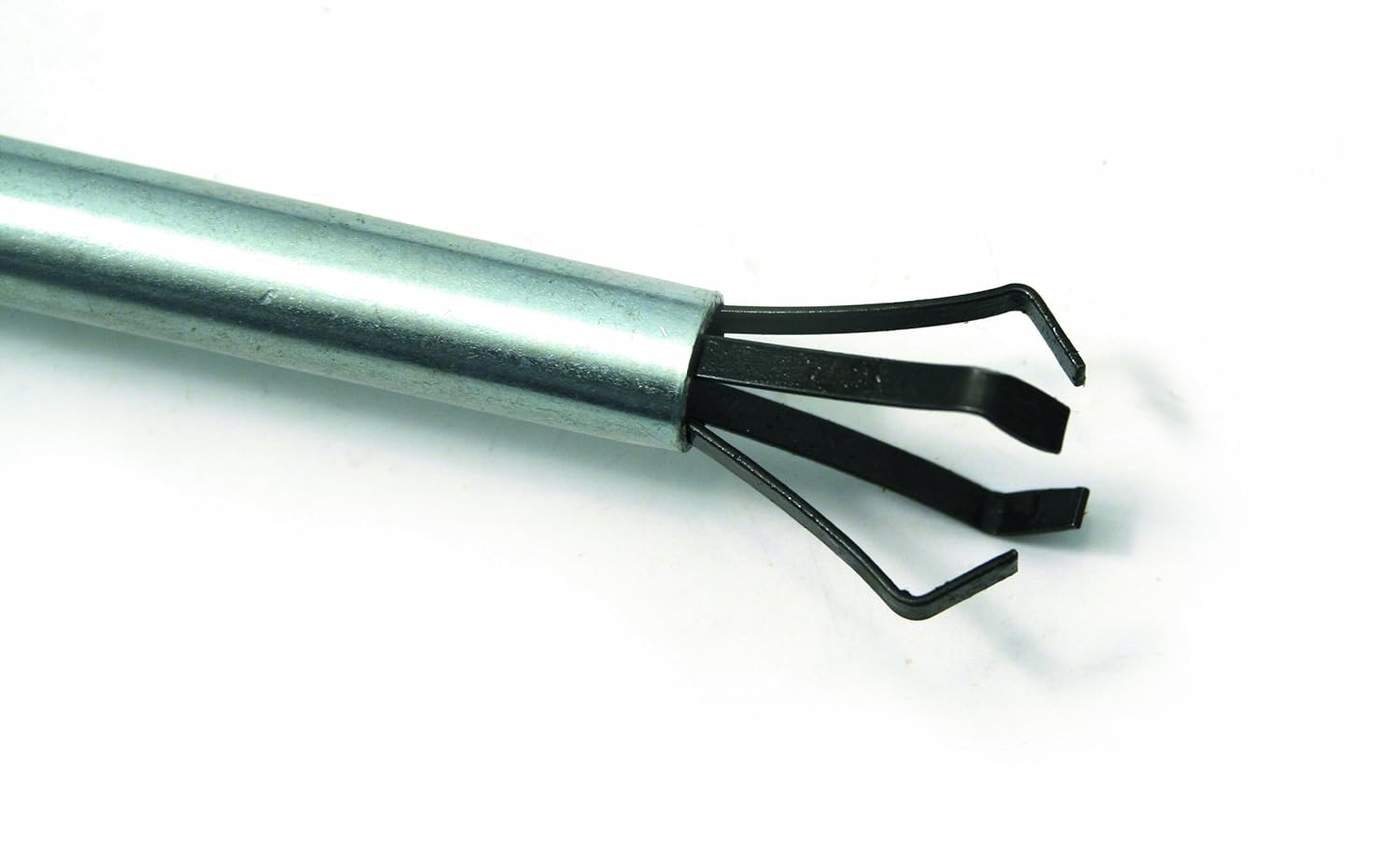

This may be worth a try?
Mechanical fingers, most auto parts stores sale them along with others who sale automotive tools.
If you can find some with a small enough tip to go through the injector hole, you may be able to fish it out with them?
Would save having to pull the head.
I have some very small ones that I have used in the past to get small parts out of some very bad and tight locations... :wink:
