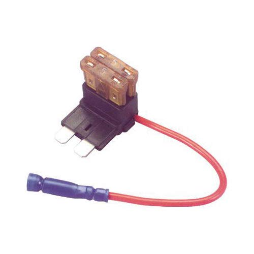

While everybodys here :-) What cable did you use for the fused ignition? I know that three of the wires go into the OBD thing and the last one has to go to a fused ignition, but where?
2005 CRD Sport
ORM&EHM with great success!
TJM T17 Bumper, 50W KC HID's
PostPosted: Tue Feb 06, 2007 12:40 am
Joined: Tue Jan 24, 2006 1:44 pm
Posts: 249
used an add a circuit to run it to the fuse box. I'll check which fuse in the morning. Wouldn't be surprised if there's a more elegant solution.

I just installed my EVIC and works great! The only concern I have is that I put the blue/white power wire to a add a circuit and ran it to #22 on the fuse box (i have an 02 Liberty )which is the wipers and washer fluid. It is 10amp. Will that fuse be ok to use indeffinetly? Im almostt 100% positive it is ok, but i'd like my fellow Jeepers to assure me it's all good. Also I read somewhere that you need to put a variance code in so that the compass works correctly. Is that true? Mine seems to be working fine, but am just curious. Thanks!!!

The EVIC draws a fair amount of power but probably not enough to overload the wiper circuit. The compass variance code makes the compass more accurate by compensating for geographic location. I don't think the variance must be programmed but it probably should be programmed.

Thanks for the reply. I don't use the wipers that much so it should be ok. Any other suggestions as to where to put the blue/white wire? I've heard to place it into the radio slot, but there are I think 3 different radio slots and I don't know which one to put it into. Anyone know how to input a variance code and where I can find it? Thanks. I'd also like to thank everyone on this amazing forum that helped me understand how to install an EVIC because it is the coolest freaking device ever!!
