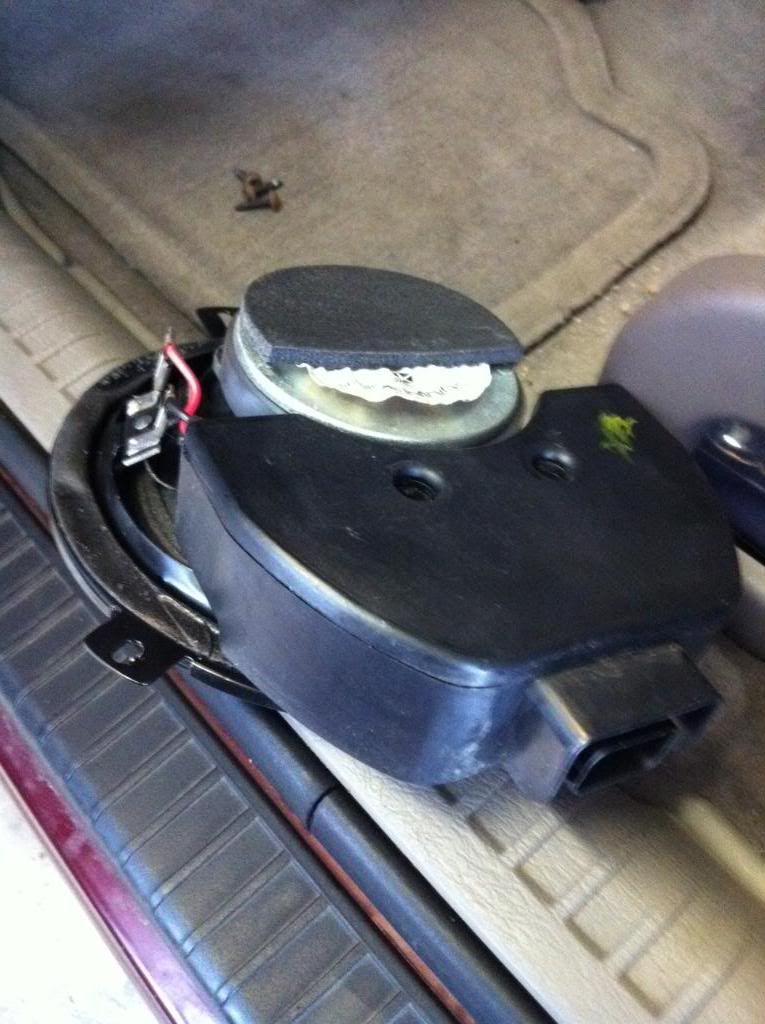

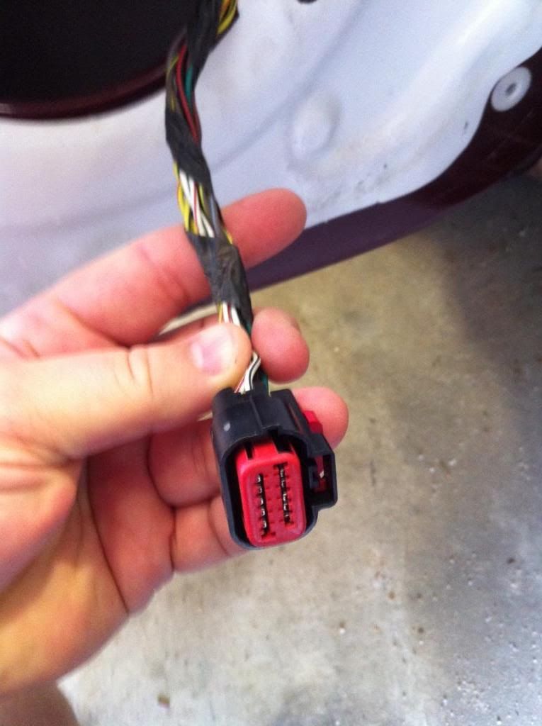

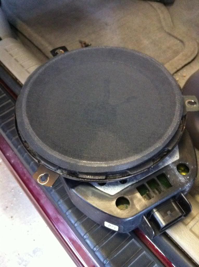

Working on my wife's 2003 KJ w/the Premium (joke...) Infinity System. I have replaced the OE Head Unit w/an Alpine CDA-117. Used a harness adapter to plug in directly to the OE stereo harness. I also used an adapter to utilize the Steering Wheel speaker controls. All of that is installed and working as it should be.
Now on to my question. I have a set of Alpine SPS-600 6-1/2" speakers that I'm wanting to mount in place of the blown paper Infinity speakers. I would like to do away w/the OE Amp that is on my OE speakers and just let the Alpine HU run the speakers. However... as I've been researching and reading it appears the OE amp powers all 3 speakers (Fr Tweeter, Fr Door, Rr Door) and so is it possible to cut the wires on the harness and just use 2 wires for the new speaker that is now fed off the Alpine HU? If I do this, will it kill the signal to the Rear door speakers? (Note: I don't care about the tweeters... unless there is a way to utilize them too)
Here are some pics and I could use some assistance for sure.
Speaker w/Amp
Dr. Door plugin
If I'm forced to run New Speaker wires to the front speakers, will that kill the signal to the rear speakers? This is getting a bit complicated... or perhaps I'm just making it that way. Had to step back and get some advice.

In theory your plan will work, to continue to use the factory amp to power the rear speakers.
The color of the wires are as follows. These are the factory wire colors.
Left front door signal + dark green (from head unit to the amplifier)
left front door signal - brown/red
right front door signal + violet (from head unit to amplifier)
right front door signal - dark blue/red
left dash speaker + yellow/red (from factory amp to speaker)
left dash speaker - yellow/black
right dash speaker + tan/black (from factory amp to speaker)
right dash speaker - orange/red
left rear signal + brown/yellow (from head unit to factory amp)
left rear signal - brown/light blue
right rear signal + dark blue/white (from head unit to factory amp)
right rear signal - dark blue/orange
left rear speaker + white/red (from factory amp to speaker)
left rear speaker - white/black
right rear speaker + tan/violet (from factory amp to speaker)
right rear speaker - tan/black
How it goes is the factory amplifier on each side has two inputs and three outputs. the front door speaker and tweeter both get their signal from the channel for the front door. The rear door speaker channel has its own input and output.
What I would need to know is if the harness adapter you used has a speaker level to line level converter in it. Some factory amplifiers won't take a speaker level (powered) input, so you get a harness with a box. If that's what you have, then you will need to run new wires from the alpine deck's front speaker wires to your new door speakers. That way they will be getting full power from the deck (18 w per channel in your case). If the factory amp is in fact getting a speaker level signal from the alpine deck, (i.e. your adapter was just a plug with some wires) what you could do is cut the front door speaker + and - wires before the amplifier harness connector inside your door, and extend them to reach your new speakers.
This will power the front door speakers directly from the head unit, bypassing the amplifier. The in-dash tweeters will not function (not a big deal, the 3 way alpine speakers should sound pretty nice) and the rear speakers will still be powered by the factory amplifier.
If it were my vehicle, I would try it this way first. What else does your system consist of? Plans for any subwoofer?

Ended up getting the Alpine HU and speakers wired up. I re-used the OE Amp, mounted it to the inside of the door down low (window clears just fine) and extended the +/- wires coming off the amp to the door speakers. Then re-used the OE dash tweeter (not crazy about it, but it works for now) and the door 6-1/2" speakers work well. No future plans to add a Sub. This is my wife's DD and she doesn't care about the Sub, but wanted to be able to play her music loud again... ha. She loves it and it sounds 100 times better now than it did even when new and she drove it off the lot.
Down the road however I may re-wire and use the HU to power the front door speakers, not use the OE tweeters and use the OE Amp to run the rear speakers. She can barely turn it up to 1/2 volume now before it feels like you're ears are going to blow... :)
