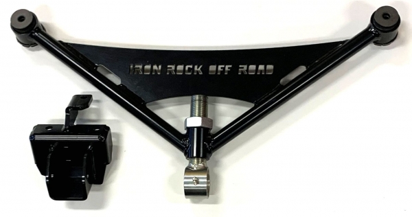

More than likely, your clunk is worn out rubber bushings in the factory rear upper "boomerang" control arm. The soft rubber bushings on each end where the control arm mounts to the body wear out and come apart allowing the metal arms to make contact with the body which are located right under the rear seat and the noise resonates through the vehicle especially when the transmission is downshifting or upshifting.
You can replace the control arm with a new factory style replacement available from IDParts or one of the parts stores that sales Moog suspension parts. DO NOT install one of the cheap chinaism ones, they are junk right out of the box!
Some owners like myself and many others have upgraded their rear upper control arm to the super heavy duty IronRock KJ Adjustable Rear Upper Control A-Arm. It has hard rubber bushings on the body ends and a greasable Heim type ball joint on the differential mount end. It will last the lifetime of the vehicle and has rebuildable and replaceable bushings and joints. It is a simple direct bolt on replacement for the stock OEM control arm. Contact IronRockOffroad.com to purchase.
