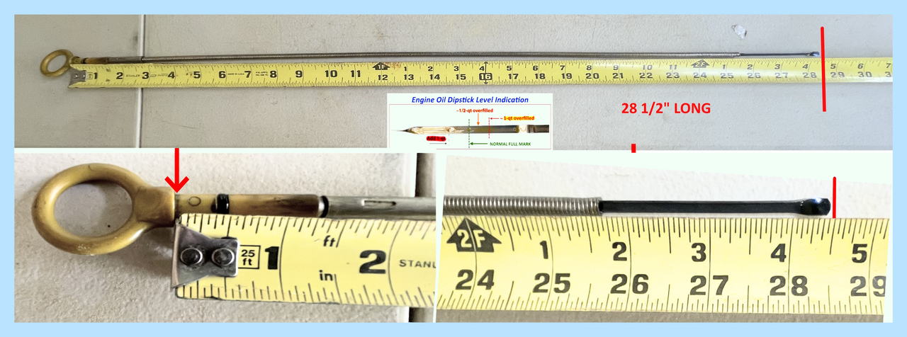

Can someone give me a measurement of the OEM 2006 Liberty CRD oil dipstick length?
I just changed oil and filter. I put 6.3qt of oil in and ran the engine for a few minutes and let it sit for 4 hours.
When I tried to check the oil level, I don't see any oil at the bottom of the dipstick.
Either there's a blackhole inside the diesel engine or the dipstick is too short.
Yes, it's on level ground. Please share the length of your 2006 CRD oil dipstick. Thank you.

No luck. It has some oil on the edge of the dipstick (same as before, I forgot to mention it), but nothing at the bottom.
Could you please measure how long your engine oil dipstick is? Thanks.

Here you go, hope it helps?

@WWDiesel
Thank you so much.
