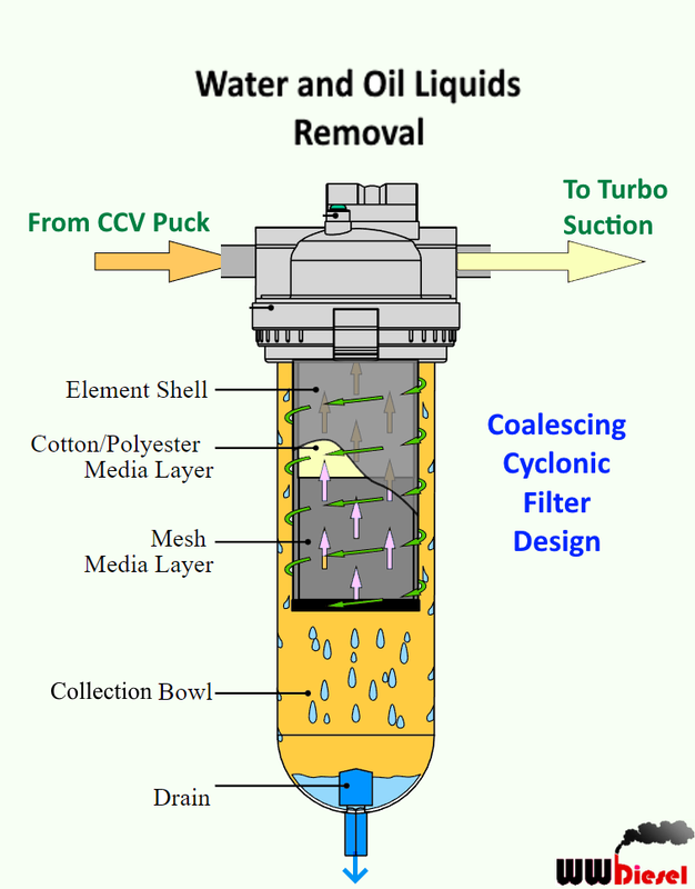

The oily vapors coming into the intake itself is not a major problem, but it does contaminate the insides of the CAC (intercooler) making it less effective and the oily liquids can condense and collect in the bottom of the charge air cooler which is NOT good. The oil will also rot the rubber turbo suction intake pipe over time that connects the turbo to the air filter housing.
That is why many owners opt to install a ProVent coalescing cyclonic type filter in the CCV line to remove 90% of the suspended oily liquids from the vapors before they are allowed to enter the turbo suction pipe and CAC.
