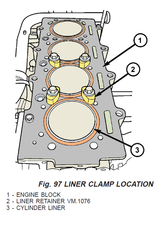

If you pull the head, you MUST install some hold downs to keep the piston liners from moving when you turn the engine over.
Item #2 in the drawing below. You can make some hold down clamps out of some flat stock or angle iron.

Thanks for the reminder, I have the factory tools, but I never use them while turning them over by hand anyhow, but I sure will for cranking speed.
