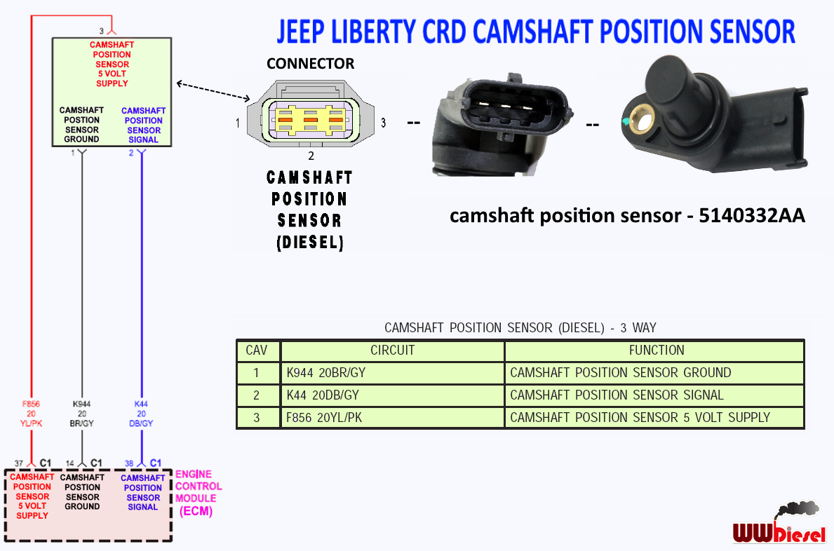

This is the wiring for the Camshaft Position Sensor:

Thanks for the drawing....

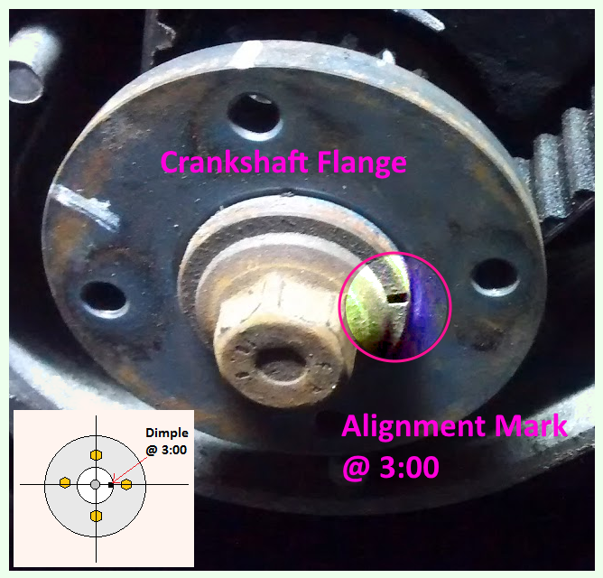

I know you peaked at the timing belt, but I would say verify it by getting the timing locking pins and see if they go in once you set the crank to the correct position. This would rule out any jump in timing.

Just as WolverineFW posted, it would be prudent to set the engine up at the 3:00 crankshaft timing position and see if the the cam timing pins will freely insert.
You got to check the basics first and rule out any timing issues. Without proper timing, nothing else you do will make one iota of difference.

I get your point on checking for it jumping time, but i had helper when i pulled the timing cover back and had him hit the starter.... many times,
watched the belt for its whole length, pushed and pulled on the timing belt ( the tension made it almost impossible to find slack), looked perfect.
has anyone ever heard of one jumping time with a good tensioner and belt ?

I still think you should physically check if it is in time with the pins in.
Otherwise, explain the camshaft sensor codes?? You already loaded up the parts cannon on that part and you still have the code. Maybe the sensor is good and is trying to tell you something......
