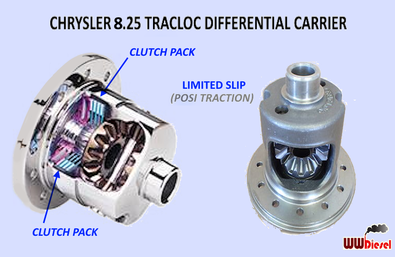

Years 02'-05' used a 3 sensor ABS system. The rear sensor is on top of the rear differential housing. 06' onward used a 4 wheel sensor ABS system. The sensors are at the wheels hubs. You would have to get one that matches with what you jeep came with.
Also, Some rear differentials came with a limited slip called the trak loc that used a clutch packs. There are rebuild kits to replace the clutches as it is a wear item. Its more of a street type locker for snow and ice and not any mild to hardcore type off roading.

I don't believe the TracLoc was available from the factory on 06 models due to the 2006 Jeep Liberty used a Traction Control System (TCS) and Electronic Stability Program (ESP) to manage wheel spin and vehicle stability using the ABS four wheel speed sensors.
The limited slip TracLoc was available on 05 and some earlier year Jeep models as an option from the factory including the Liberty.

I believe you should be able to replace the factory open differential carrier with a TracLoc differential carrier putting it in an 2006 year model 8.25 rear-end housing.
Reuse your OEM factory gears. (If they are still in good shape?)
It will require setting up all the clearances, backlash, runout, bearing preload, tooth contact pattern, etc...
It is recommended to use a new master install kit, including new carrier & pinion bearings.
