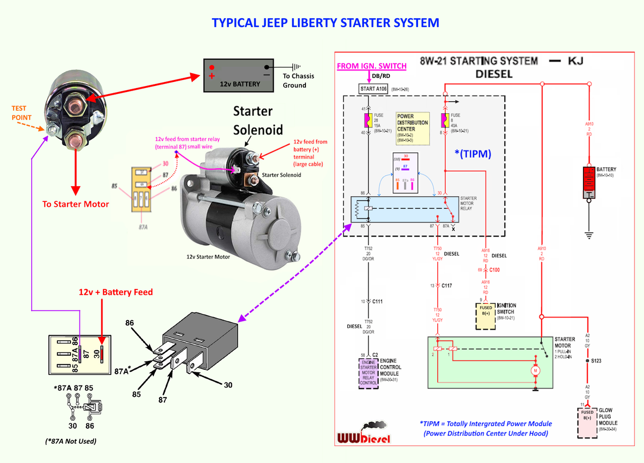

Items you need to check/test:
1) terminal 86 at starter relay in the TIPM. Pull the relay and measure ohms at terminal 86 on the board when starter key switch is turned to the RUN
position.
ECM grounds this terminal to allow the starter relay to energize/engage when the ign. switch is turned to the START position. If this ground signal (ohms) is
fluctuating or weak, then the ECM is not providing a proper or continuous ground to allow the starter relay to fully engage.
2) test/read voltage at terminal 85 at the starter relay plugin on the TIPM board when the ign. switch is turned to the fully START position. You should have a 12v
steady voltage reading at this terminal when the ign. switch is turned to the fully start position to energize the starter relay. (12v coming from terminal 1/A106)
3) ASD relay, have you tried swapping it with another like size relay? It gets energized by the ECM when you turn the key to the run position if all the signals
from the items required to be able to start the engine. i.e. brake pedal switch, transmission in Park or Neutral etc...
4) You may have a bad ignition switch (electrical part)? When ign. switch is turned to the fully start position, use a voltmeter to read the voltage coming from
terminal no. 1 of the switch. This is A106 which is a DB/RD (dark blue/red) wire as shown in the enclosed diagram.
5) Clean battery cable connections at battery, check all grounds for good solid connections. A poor or weak ground can cause all kinds of weird problems.
**using a voltmeter/ohm meter, you should be able to determine where the problem is located....
