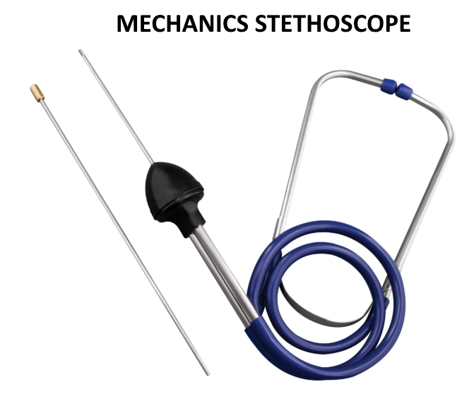

Not 100% familiar with how the 06 will react if picked up on a lift/rack with all four tires off the ground and spun up to speed. (45-60 mph)
Doing this you can test/listen for noise location using a mechanics stethoscope while someone holds the speed steady.
Done this on plenty of vehicles in the past including my 05 Jeep Liberty, but it does not have the traction control of the 06's.
It simply set a ABS warning light along with a check engine light that went away as soon as I drove it for a little piece on the ground.
Can you turn the traction control off or unplug the ABS module power supply fuse long enough to test for bearing noises on a lift?
Another thought, if you are running any kind of tire other than highway tread; tire noise will really fool you and make you think you have a bearing going bad.
Remember, it is a unibody vehicle, so tire noise transmits very easily from the tire to inside the cabin.
That is why lifting all four tires off the ground and spinning them up to speed while listening with a Stethoscope will give you a true indication of where any bearing noise is coming from.

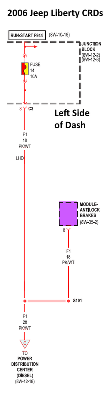

NOTE: FOUND THIS INFORMATION ONLINE: wrote:
You can safely unplug the ABS module or pull the ABS fuse to spin the tires/wheels up to speed on a rack without activating the traction control or causing damage. However, rather than unplugging the module's main wiring harness, it is highly recommended to simply pull the ABS/Traction Control fuse.
On the 06, it is fuse #14 in the "Junction Block" fuse panel on the left side of the dash according to the 06 factory service manual wiring diagrams.

Thanks WW, you're the best. I wants to lock up the brakes on the 06, I'll have to give it a try with the fuse out.
