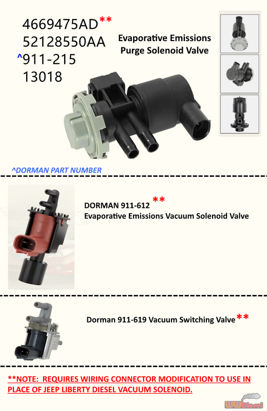

You can also just bypass the vacuum solenoid. Its only function is to hold the vacuum in the small vacuum chamber for the turbo vane controls.
With it bypassed, just allow the engine to idle for a 30 seconds or so to build up some vacuum.
See this picture to bypass the solenoid:

Why not bypass it?
There are plenty of 12v vacuum solenoids available on Amazon for cheap. https://www.amazon.com/vacuum-solenoid- ... noid+valve
You may could rig one of them up to work until you get the correct part? Just be sure and get one that is normally closed. :wink:
It is just a simple open/closed valve. Power is applied to it (open) when you turn the key to the on position.

2. There are some 12v vacuum solenoids used on other vehicles that could be used in place of the non-available factory solenoid with possible wiring/connector modification. See picture 2 The vacuum solenoids are on or off electrically controlled valves and do not perform any modulation.
**Keep in mind, the only function of this solenoid is to maintain the vacuum in the small vacuum reservoir when the engine is shut down. Solenoid closes to hold vacuum so it will be available for the turbo modulator valve the next time the engine is started. With the solenoid bypassed, vacuum will not be maintained and will have to build back up when the engine is restarted.

2.
