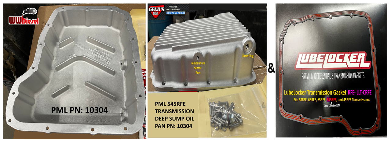

When your pocketbook recovers, seriously consider installing one of the PML cast aluminum transmission oil pans, or one of the other high quality aluminum oil pans with cooling fins, and equipped with a drain plug and a threaded temperature sensor hole. Deep sump is best if you have the room.
PML Offers three versions, stock, 2 quarts extra fluid capacity, and a deep sump that holds an extra 4 quarts ATF+4.
Part numbers:
Stock: 11078
2 Qts extra: 11079
4 Qts extra: 10304
And to go with a cast aluminum oil pan, consider using the LubeLocker oil pan gasket which is impregnated with silicone sealant and is reusable.

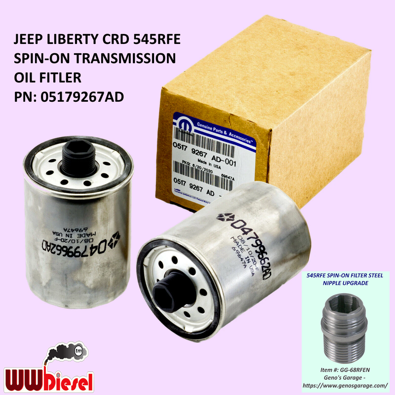

**And ONLY USE the Mopar brand round filter inside the transmission, OEM Number: 5179267AD

I already put a drain plug in the stock pan, put one in my pickup truck as well. I already changed fluid, and filters in my Jeep a few times over the past 20 years.
With a Hemi transmission not towing anything, I doubt it needs anything extra.
