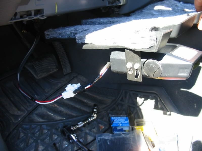

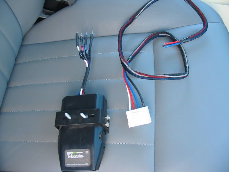

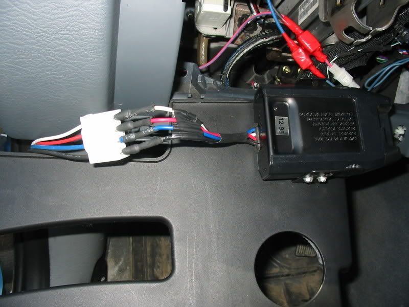

I also promised to add pics of my brake controller install. In a nutshell, I wired my Tekonsha Voyager into the system (removable) using some blade connectors on the controller outputs, and buying a REESE e-brake harness for a Dodge Ram p/u (because that connector shape worked best with blades compared to GM/Furd/Toyota harnesses)
My Voyager controller and REESE/Dodge harness:

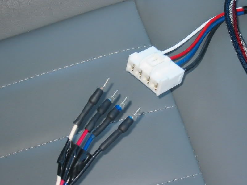

Close-up of the connector:

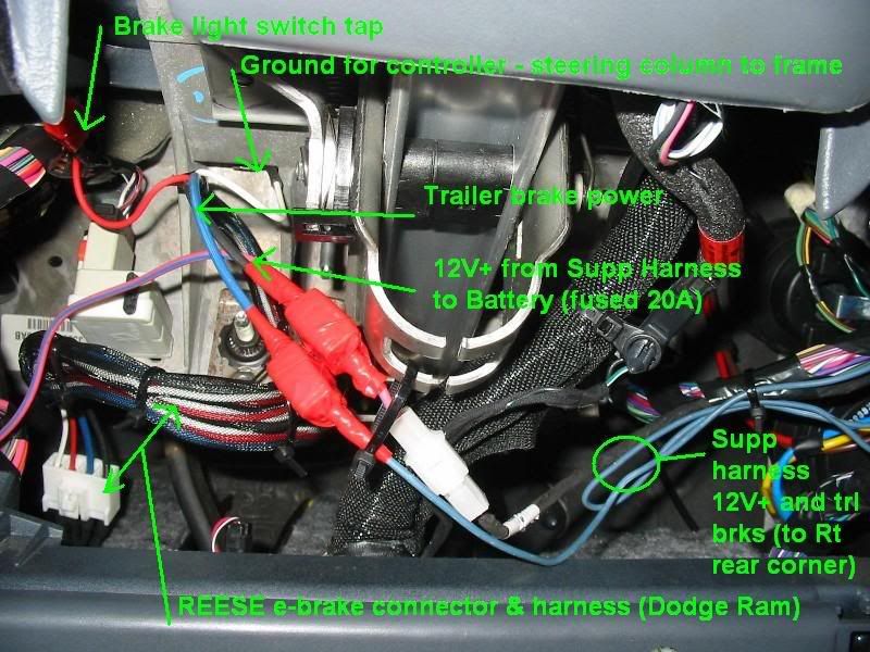

Close up of the harness brake signal and ground hooked up. I took the brake light switch harness off and tapped the brake signal (white w/ tan trace) about 4" from the switch itself and re-installed -- didn't want to break the "one-use only" switch.

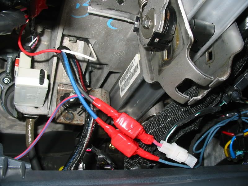

Lt.blue controller wire from the Dodge harness tapped/butted to the supplemental harness trailer lead, and for powering the controller, I tapped of the supplemental harness's 12 ga. Batt+ wire that I had hooked up already to the battery with the 20A in-line fuse. I figured rather than go hunting for another 12V+ or sting another wire through the firewall, I'd just use the 20 amper from the supp harness I had already pulled through. I would not have any 12V load on in the trailer anyway while I'm towing, so I'm not fussed about twinning off the pk/lb 12V+ to power the controller...the ampacity is within spec per the instructions.

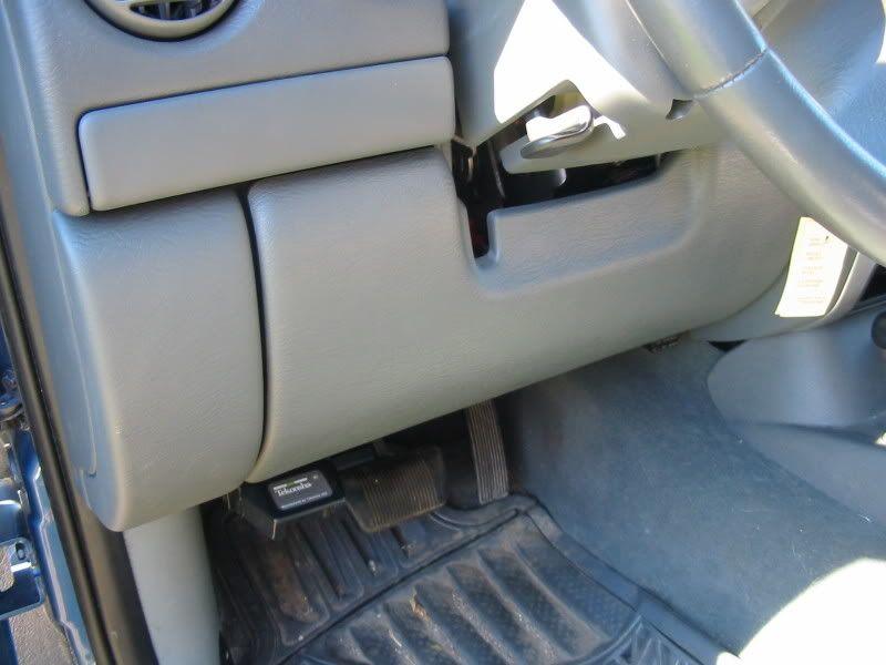

Controller mounted onto the black pedal cover (good access to remove/store the controller when not towing.)
I through-bolted the controller mount to the black plastic pedal quadrant cover -- the plastic is fairly robust for my needs and allows me access to the level, gain and manual slide, let's me see the status light, yet is non-obtrusive in the cabin.
What everything looks like under the dash. You can see the controller wires coming up from beneath the black cover to the white REESE connector, that I've zap-strapped the excess length and then branched off to the four connections (brake lt, grd, controller output, 12V+).
The end product! Electrically tested, works fine. Now to report elsewhere how the towing goes...
Hope that helps some who may have been wondering about the additional wires in the connector thing.
