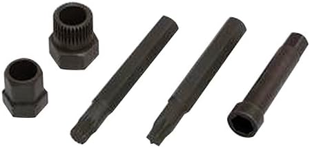

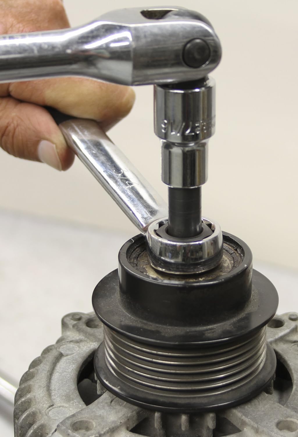

jagster936 wrote:
Hmm, I just tried to do this and it was a normal 10mm bolt in the center; using a good quality socket and powerful impact it just stripped it out, great. Not sure what to do now, probably new alternator.
The 10mm bolt head is the actual end of alternator shaft itself. You use it to hold the alternator shaft stationary while loosing the one way clutch pulley using a 17mm hex head wrench as shown in the first picture below.
You can also just use an impact wrench and a 17mm hex socket and spin the clutch pulley off without having to hold the alternator shaft stationary.
I have done it this way a couple of times, but it takes a very GOOD 1/2" or 3/8" drive 17mm hex head wrench to do it this way. You may have to hit it several times to get it turn loose.
Since you have rounded off the 10mm end of the alternator shaft, removing it this way may be your best option.
There are plenty of tool kits online for performing this task manually.
https://www.amazon.com/Lisle-57650-Alternator-Decoupler-Tool/dp/B00AGWEUKI
Alternator Pulley Removal Tool Kit

My dad showed me this now I feel really stupid. I got her swapped when used the Allen I was thinking that was a center bolt like many other pulleys Ive dealt with! Thank you!
In method you describe you need a way to hold the center shaft. Some sort of special tool? Or a 17mm Allen that is hollow so you can hold shaft?
