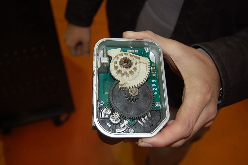

The KJ CRD target consumer was the soccer-moms and -dads that were looking for better fuel economy, but were totally unaware of Diesel-fueled vehicle concepts and operation
- gasoline engines function with a throttle plate which is closed at idle and key-off - this blocks air intake such that the compression stroke has little air to compress = engine stops smoothly
- Diesel engines have no throttle plate so pistons draw full volume of air on each intake stroke - at idle and key-off pistons continue to compress that full volume of air resulting in that massive death-rattle, shaking the entire vehicle -
I've had females squeal in terror during those initially-experienced death-throes known and accepted by all Diesel pickup drivers - not even good for Jeep sales
- KJ ECM closes the FCV at key-off, blocking air intake similar to a gasoline engine, so new-to-Diesel consumers would not constantly be returning the li'l puffer for warranty concerns: closed = no death-shake, rattle, and roll = soothing to wimmin occupants
- ECM immediatly opens the FCV when crankshaft stops rotating - if functional, you should hear the muted whirrrrr of the motor-driven gear-train after key-off
Note missing teeth on beige rack gear, crunched teeth on gray pinion gear:
Foto courtesy of can't remember who
ECM cycles FCV closed\open during wait-to-start to verify functional operation, enabling the Check Engine Lite CEL if not fully operational, which you would see DTC with a scantool
- usual failure is some point between fully closed and fully open, allowing engine to start and run, but not very well - f'rinstance, some power but black smoke
So, if you're still with me, inspect the FCV - if the throttle plate is not fully open, remove the plate
