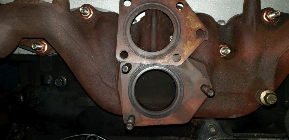

The river has gone back down so I can drive out to the machine shop tomorrow with my head.
I checked the turbo gasket I got with my head gasket kit from IDParts and it fits, it has the arrangement for a 4 or 3 holer.
1998 XJ 4.0L, 2" lift

ARRGGG!
I hadn't really inspected the exhaust manifold that closely - until it was time to put this all back together. Looks like a tap is broken off in one of the 3 stud holes! Bugger! :furious:
What are my options for an exhaust manifold? Junk yard? I don't see that IDParts or Saquatch lists one. :banghead:
And can I go ahead and install the rockers & intake etc while waiting on this? The FSM says head, then turbo, then rockers, then intake, then...
Man, I was hoping to get this back together over the holiday break...

Posts: 652
Just to be clear, one of the three studs is broken?
Take it to a machine shop, they'll get it out. They usually charge $20 or $40, much cheaper than a replacement.
Also, 99% sure my turbo only has three bolts. I remarked on it when I removed it. It's an '05, not sure of the production date offhand.

Yea, out of the 3 studs, one of the holes has a tap broken off in it, not the stud. It was attached by 2 studs & nuts. I was so focused on figuring out why I had a 3-hole turbo I neglected to inspect the exhaust manifold. Ba humbug!!!
I'll check with my friend at the machine shop if he can remove or drill out a tap. I guess while he has it he could make a plug for the EGR port too.
So your turbo is a 3-hole too, not 4? Interesting...

Posts: 652
Yep, just 3. The gasket is clearly designed to accommodate 3 or 4 studs, so it can't be that unusual.

Interesting. The new gaskets are the same way.
My buddy with the machine shop was able to tickle out the broken tap so I'm back in the saddle. New studs should arrive today.
Aye, got one of those in a few weeks ago. Exactly the same.
This thread made me go look for replacement turbos, and it sure seems like nobody distinguishes between 3-bolt and 4-bolt turbos. Makes me worry that if I ever needed a turbo, I might also need a 4-bolt manifold. That doesn't make me feel great.

Posts: 421
Location: Central KY
All the ones I’ve found were 4 bolt. Looking at the manifold, I think it could be drilled and taped for 4 holes. Two of the originals are blind and one is open.
