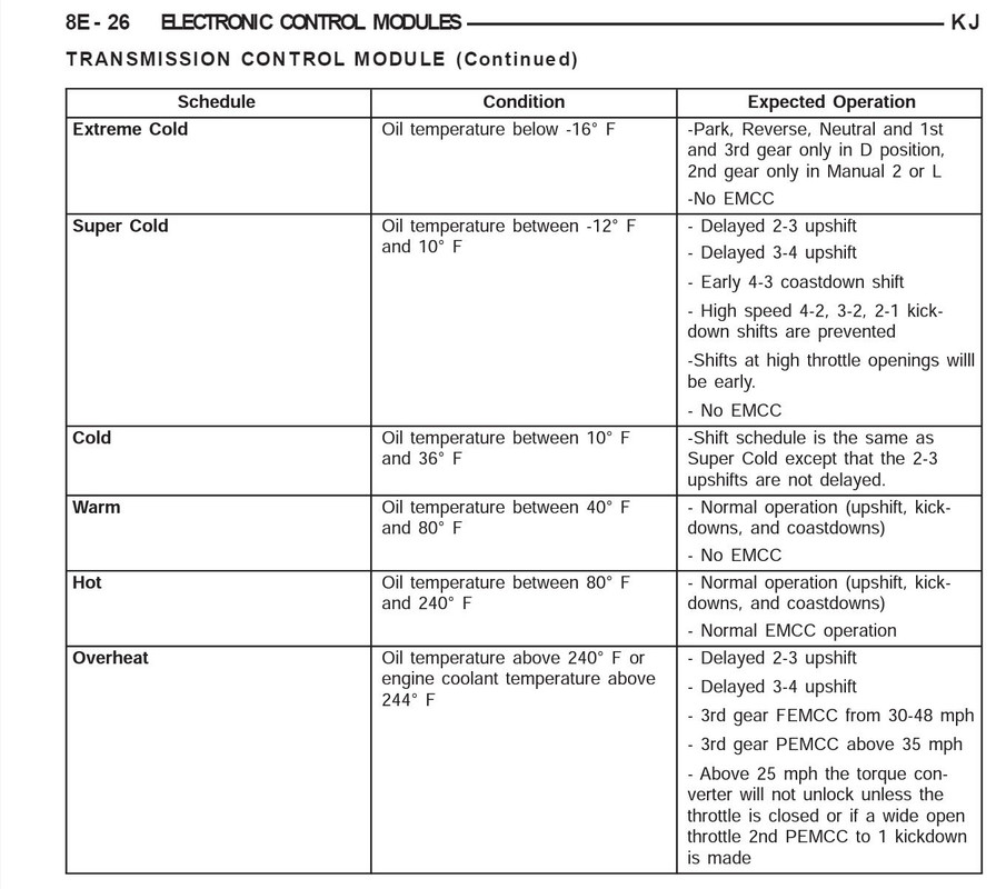

In the 2005 Factory Service Manual it starts in section 8E - pg. 26, ELECTRONIC CONTROL MODULES KJ
TRANSMISSION CONTROL MODULE (Continued)
FSM Available on line at:> https://www.colorado4wheel.com/manuals/ ... Manual.pdf
FSM wrote:
TCM QUICK LEARN
The quick learn procedure requires the use of the scan tool.
This program allows the electronic transmission system to recalibrate itself. This will provide the proper transmission operation.
The quick learn procedure should be performed if any of the following procedures are performed:
² Transmission Assembly Replacement
² Transmission Control Module Replacement
² Solenoid Pack Replacement
² Clutch Plate and/or Seal Replacement
² Valve Body Replacement or Recondition

I thought less oil pressure would PREVENT a TC lockup? As it uses oil pressure to lock. I was thinking about this?
Also, that table in the manual is very interesting. Perhaps I'm getting a bad sensor, or REALLY have an overheat fluid situation (cooler blocked?). This causes specific 2-3 and 3-4 delays and other issues. I'm almost willing to bet it's one of those. Since it's so predictable when it's hot. Sensor could be out of range or etc. Where is the transmission oil temperature sensor? Nonetheless I could read that with proper scan tool, hmmmm
One thing to note, when I disconnected the cooler lines only got a couple of drips none pouring out or anything. Is this expected? That top line is impossible to disconnect with it fully installed now, I had to lower tranny to get it to come all the way out, it hits the wall there. I wonder if some other way to see if fluid is flowing, maybe measure line temps to and from the cooler perhaps
What is FEMCC and PEMCC? I don't see explanation anywhere

Abbreviations:
EMCC = Electronically Modulated Converter Clutch
NO EMCC = No Electronically Modulated Converter Clutch
PEMCC = Partially Electronically Modulated Converter Clutch
FEMCC = Full Electronically Modulated Converter Clutch
Theory of Operation: When in 2nd, 3rd, or 4th gear, the Torque Converter Clutch (TCC) can be locked (FEMCC) or partially locked (PEMCC) when certain conditions are met. The TCC piston is electronically modulated by increasing the duty cycle of the LR/TCC solenoid until the torque converter slip difference (difference between engine and turbine speed) is within 60 rpm. Then the LR/TCC solenoid is fully energized (FEMCC / 100% duty cycle). Torque converter slip is monitored in FEMCC to ensure adequate clutch capacity. The transmission will attempt normal EMCC operation (not in limp-in) even after the MIL is illuminated. MIL will illuminate after five minutes of accumulated slip in FEMCC.
When Monitored: The Torque Converter Clutch (TCC) is in FEMCC or PEMCC, Transmission temperature is hot, Engine temperature is greater than 38°C or 100°F, Transmission Input Speed greater than engine speed, TPS less than 30°, and brake not applied.
Set Condition: The TCC is modulated by controlling the duty cycle of the L/R Solenoid until the difference between the Engine rpm and the Transmission Input Speed rpm or duty cycle is within a desired range. The DTC is set after the period of 10 seconds and three occurrences of either: FEMCC – with slip greater than 100 rpm or PEMCC – duty cycle greater than 85%.
Possible Causes: LR/TCC Solenoid malfunction or Internal Transmission failure.
