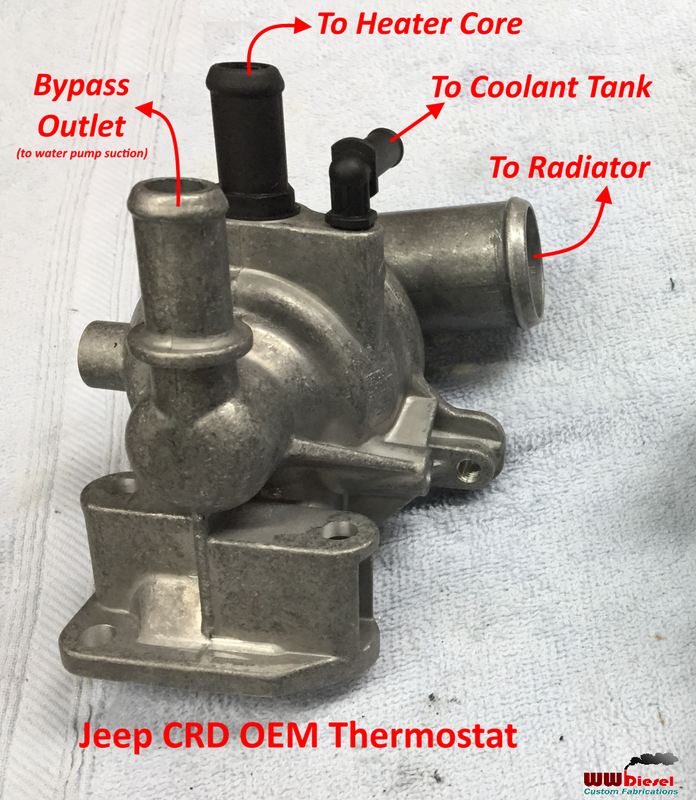

Clearly you do not understand the long term implications of using an inline thermostat valve, and you also do not understand the gravity of your own diagrams.
Our concerns have nothing to do with whether or not your engine will warm up adequately, but rather with other unintended consequences. We do know that the inline thermostat modification will indeed warm up your engine and everything will seem fine, but you are slowly warping your head with this modification.
Your own diagrams show that the cooling system bypass circuit is permanently shut down when you leave a failed O.E. thermostat assembly in place, as the CRD engine has a valve controlled cooling system bypass circuit. This essentially relegates your engine's cooling system to a 1 circuit cooling system; the one flowing through your radiator. If you stick another thermostat anywhere in the radiator circuit in conjunction with a failed O.E. thermostat assembly, any time that additional thermostat is closed down you do not have adequate coolant flowing through your engine. Hot spots will form - starting right at the exhaust ports - and your head will warp over time.
There is also another problem with the "Renault 5 Hack"... the thermostat valve designed for the Renault 5 engine is sized for that engine, the biggest version of which is 1.4L. Do you think that maybe, just maybe it might be a tad too small to flow enough coolant for an engine that is twice the displacement and more than twice the power and weight? Try towing with any CRD that has the Renault 5 Hack, and you are looking at a real overheat situation. Here is a link to the entire history of the Renault 5 and the engines used in it...

Relying on the OEM temp gauge of the vehicle is a big NO NO, a tad bit bellow top mark is anywhere between 165 and 210. If you think your engine temp is stable because the OEM gauge is not moving, you are wrong.
The number of blades and the material the fan is made of as nothing to do with how much air it will push, it as more to do with the pitch and the shape of the blades. For Geordi and is "theory" :dizzy: about more blades is more better because that's what submarine are using is also wrong. A military submarine impeller is design to avoid the noise produce by cavitation. It might actually be less efficient than a regular boat....It is also for WATER not air :ALONE:
So jeepsterkj you don't have much to back up your theory about the R5 Stat mod. You might just have been lucky you didn't damage anything yet.
This CRD engine is very high maintenance and very expensive to rebuild. It is also not a low budget vehicle keep that in mind.
The only viable alternative to the OEM Stat housing is the model 001, one of the best engine mod for the CRD !

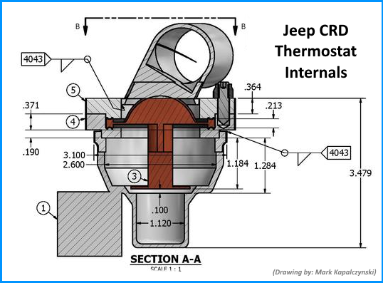

Yes... as I have posted earlier on another thread Mark Kapalczynski has made the best modification of a O.E. thermostat assembly that exists. Here is what I posted...
"Mark Kapalczynski is a GREAT GUY, and his thermostat upgrade is the ONLY one I recommend if you can not afford mine. I respect his design of a modified O.E. housing to take the Hyundai Excel thermostat valves because he is respecting the original design of the CRD engine thermostat assembly. He realizes that there were very good reasons why the O.E. thermostat assembly was designed this way and copied the design and function of it merely by modifying the O.E. thermostat housing and making it serviceable.
The problems with his design are all due to the cheap cast housing he was forced to work with. Your statement that it leaks does not surprise me, but that is certainly nothing that Mark could be faulted for.
Mr. Kapalczynski's design is no longer viable because one of the critical parts to make it is so hard to come by. I did some research back in 2013 to find out if I could take over making O.E. thermostat upgrades as Mark indicated that he no longer wanted to do it. I discovered way back then that the KIA Sephia thermostat cap was a discontinued part.... when I factored this sobering reality with the logistical problems of sourcing used O.E. thermostat assemblies I knew it was a no-go for me.
At that point I knew that if I wanted to create a truly superior upgrade serviceable thermostat I had to start with a clean sheet design. The Hot Diesel Solutions Model 001 is the result of my research and development efforts.... it is vastly superior to the throwaway O.E. thermostat assembly in EVERY way, and better than any other alternative solution - including Mark's design - that has been tried so far."
Here is your quote from the other thread when I asked you what 195 degree thermostat you were writing about. You replied "Kapeznpickic mod. Using kia parts etc. lathe work and welding, and leaks, but works great". The fact that the Kapalczynski modified O.E. thermostat housing is prone to leaking should serve as a warning to others considering this modification.... the O.E. cast housing simply does not have enough metal to install more than two 6MM studs to hold everything together in the long run, and I fear that there may be catastrophic failures because of this. The Model 001, on the other hand, has three 8MM stainless steel studs set in a very robust machined housing made from solid blocks of 6061 T6 aluminum; as such it will never leak if it is properly installed.
An additional problem I have with the Kapalczynski mod is that it uses a thermostat from a 1.5L naturally aspirated four cylinder gas engine that makes about 1/2 the power and weighs about 1/2 of a CRD engine. There is little chance that a thermostat sized for such an engine will flow enough coolant for the CRD engine in high demand situations, like towing a heavy load up a hill in the summer. You are likely looking at an overheat situation if you try to tow anything significant with a Kapalczynski mod.

thesameguy wrote:
I've got one in the garage right now that I won't be reusing, but I've no reason not to take your word for it. If the factory thermostat is a dual poppet, I 100% agree running an inline thermostat would be a very risky proposition. Undesirable restriction or not, defeating the coolant bypass sure seems like it'd be a big deal. Maybe you luck out and the real-world result don't affect you during your ownership, but it's not something I'd be willing to bet my cylinder head on!
Hopefully these drawings will help show the "guts" of the Jeep OEM thermostat and how it was designed to function normally.
It definitely is a duel valve thermostat! As the bypass valve closes off, the main valve opens to permit flow to the radiator.
