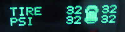

The 06 Liberty Ltd with package G comes with the "simple" tire monitor. In this version the computer monitors the tire pressure and if there are issues it displays general "low tire pressure warning" messages on the EVIC.
I ordered my CRD with the $75 option for the factory to add the tire pressure display to the EVIC. (And so, yes, it requires the EVIC be installed.) Pressing the STEP button on the EVIC will eventually reach a display of a small, overhead outline of the vehicle with psi numbers next to each tire. The manual warns not to consider it authoritative. I've found it has always been very close to my tire gague. (I originally posted it displayed in 1/2 psi increments. Don't know what I was smoking. Probably thinking of my digital tire gauge. )
The spare tire is not on the display -- it is still handled by the simple monitoring.
As far as I know, the monitoring hardware in the tires is the same for the simple monitoring or the individual tire display. The difference is just a change to the EVIC to add the extra display. So, I suspect if you already have an EVIC it should be trivial for the dealer to add the tire pressure display.
This is what the $75 EVIC option looks like:
It was a tad chilly that morning and the pressure had dropped in all tires.

"Tire Pressure Monitoring" is "included" with certain option packages on the CRD. However, this is only the equipment to monitor tire pressure. The actual display of tire pressure psi on the EVIC does not come with any package. For 2006 the tire pressure display on the EVIC is an optional extra.
I don't know why DC did this other than to squeeze more money out of the customer. The tire pressure monitoring hardware is already in the vehicle. If the EVIC is installed the tire pressure readout should have been included.

There's no extra screen -- It appears on the EVIC display. Pressing the Step button on the EVIC cycles through a number of displays. Adding this option to the EVIC gives another option/display to Step through.
