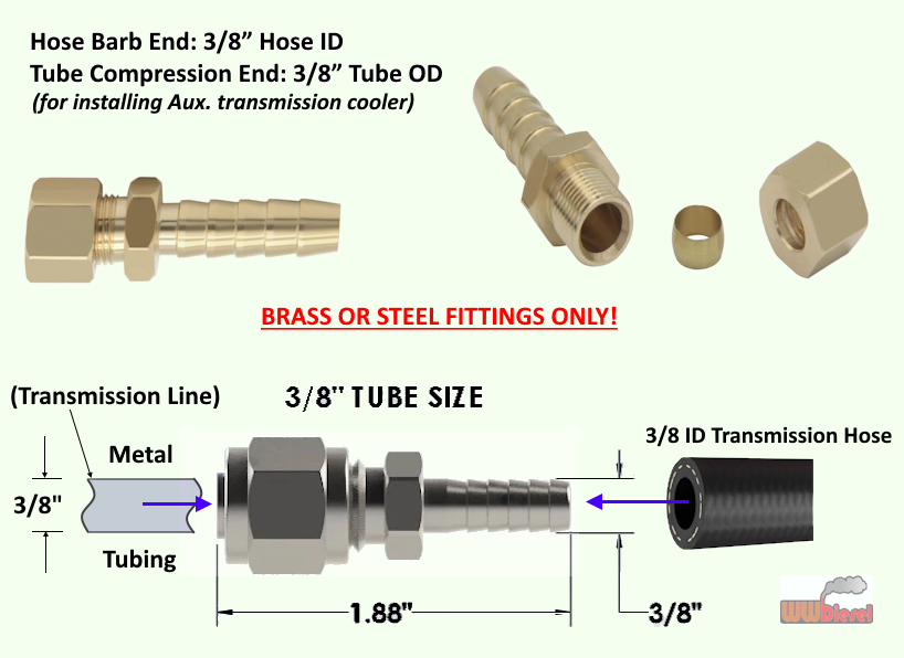

Many thanks again, WW, for the info. I’ll order one of the pans today and get it installed. Appreciating your experiences with our CRDs, I’d like to know if you see a problem with simply cutting the metal trans fluid return line and double-clamping the rubber line onto it. Over the years on other applications I’ve seen that, IF it’s done right, this can be a fully sufficient way of doing the job.
 Post subject: Re: transmission cooler??
PostPosted: Mon Apr 21, 2025 3:19 pm
Posts: 7461
Geno's Garage is a good place to order the PML oil pan from: (545RFE Same as 68RFE) Geno's has them for $100 off retail price right now.
PN: PML10304
https://www.genosgarage.com/product/PML ... ssion-pans
If you simply cut the metal fluid line, I would put a slight flare on the end of the cut metal line to help hold a rubber hose on the line when clamped.
3/8" PEX crimp type clamps really work well for installing rubber hose on metal fittings. Never have to worry about them working loose like screw type clamps.
You can buy them at hardware and builders supply stores or order them online. (Can crimp them with a pair of end nippers, no special tools required)
Or you could get two 3/8" compression fittings that use a metal ferrule compression ring to clamp down on the metal line and a barbed 3/8" hose fitting on the other end to attach your rubber hose to. This would be the safest way to do it.
