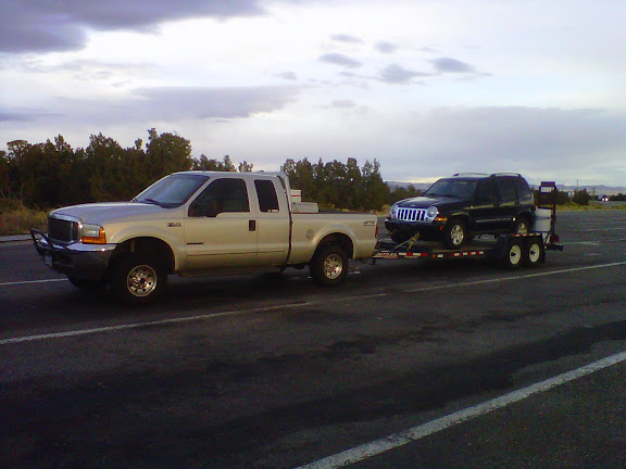

Well. I did it. 36 hours and 1550 miles later it's in my driveway. It was nicer in person than I expeted. the rear axle is definately toast, it's obvious the front pinion seal was out and it was driven with no fluid. I have already purchased a replacement axle from a 2005 CRD with 53K on it. THe bad rear axle turned into a $3,000 dollar deduction from the dealer who was selling it. It starts up easy, runs smoothly and drives out well (except for the HOWLING rear end). IT's still pretty tight.
Details:
Purchase price $7,000
Rear axle: $900
Timing belt fluids, etc $700
TOTAL $8600 plus a little elbow grease got me a black CRD limited with NAV, leather, heated seats,power everything, sunroof, never been wheeled, new tires, no dents dings or tears. It even has the owners manual and NAV CD!
The trip:
The car:
I'm pretty excited to finally have one. I'm sure that in the next month I'll have a lot of questions, as I do some of the MODS to make it a little more reliable. I am almost certain that I will be getting a GDE eco tune as soon as I have finished the Timing Belt replacement.
Thanks for being such a valuable resource. Let's keep this forum going until the wheels rust out from under my little CRD!
Jason
2005 Black Limited CRD, GDE ECO tune otherwise stock. 165K and hoping for 500K
 Post subject: Re: 2005 limited for sale in Utah - anyone familiar with?
PostPosted: Wed Oct 06, 2010 3:04 pm
Posts: 2121
Location: Kentucky, USA
SWEET.
And, somebody has changed the wheels on it too. The CRDs all were shipped with only one style of wheel, and that ain't it. :)
PostPosted: Wed Oct 06, 2010 7:17 pm
Joined: Wed Jun 16, 2010 6:10 pm
Posts: 75
@ libertyCRD: What were the wheels shipped with it? I most commonly see those wheels on libertys, I assumed it was the same for the CRD's
PostPosted: Thu Oct 07, 2010 7:46 am
Posts: 2121
The chromed 5-spoke style was the only one used on the CRDs. Looks like somebody put the painted 6-spokes on yours.
In fact, my Jeep came with 17" premium chrome wheels according to the Limited package it had...but the CRD package caused the wheels to be downgraded to the 16" regular wheels.
