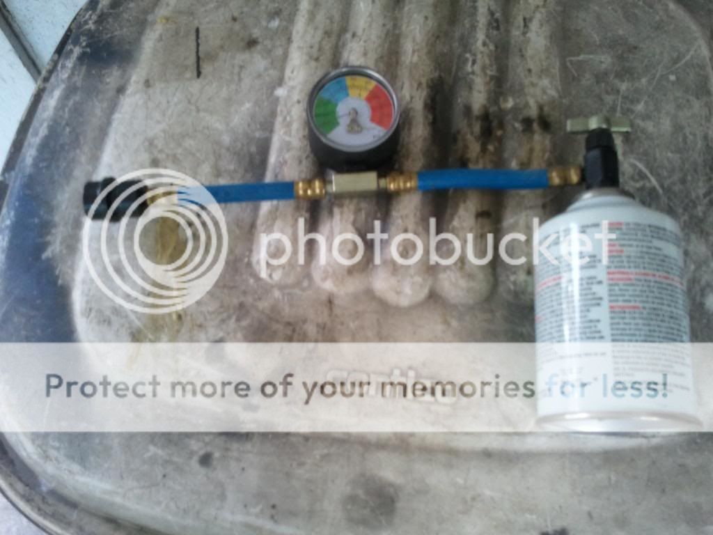

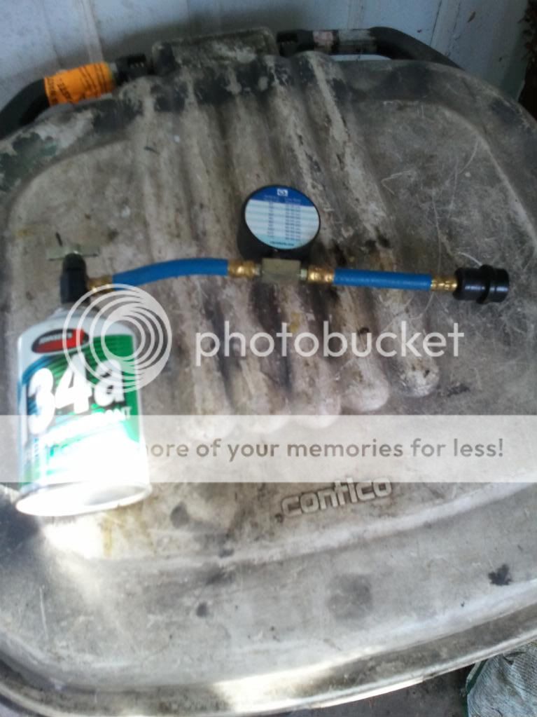

 Post subject: Re: ac refill on crd ??
PostPosted: Sat Mar 26, 2011 7:58 pm
Posts: 3554
Location: Aurora, IL
For those who don't have the manifold gauge set here is an option that is cheaper than the Steelership or the ChChing (not all AC shops are crooks)AC Shop:
http://www.amazon.com/EF-Products-Synth ... B0002KKLJS
For across the pond: http://cgi.ebay.co.uk/CAR-AIR-CONDITION ... 2a0a58cc09
Read the instructions and since the low side fitting can not fit the high side, you won't blow up the AC system.
Where you connect of North American versions, and some Euro ones:
The tool bought from Auto Parts Store:
Back side of tool:
Chart on back side of gauge so you get it right:
Never add more than what is recommended, your AC will not cool as well and overload the compressor, even lock it up.
If the compressor is fried, belt squealing and showing signs of overloading, most likely you have a clogged orifice tube.
The tool is only for use when you have lost a small amount of R134A and want to top it off to compensate for slight loss over several years for when the reading is slightly less than the optimum reading on the chart. If you are at 0.0PSI on the gauge when you connect it, you have big problems, better see a real AC shop and get the leaks fixed. Count on having to shell out for a receiver dryer and having what ever leaked out fixed. Leak could be "O" ring, line, hose, compressor, condenser, evaporator, or other leak source.
