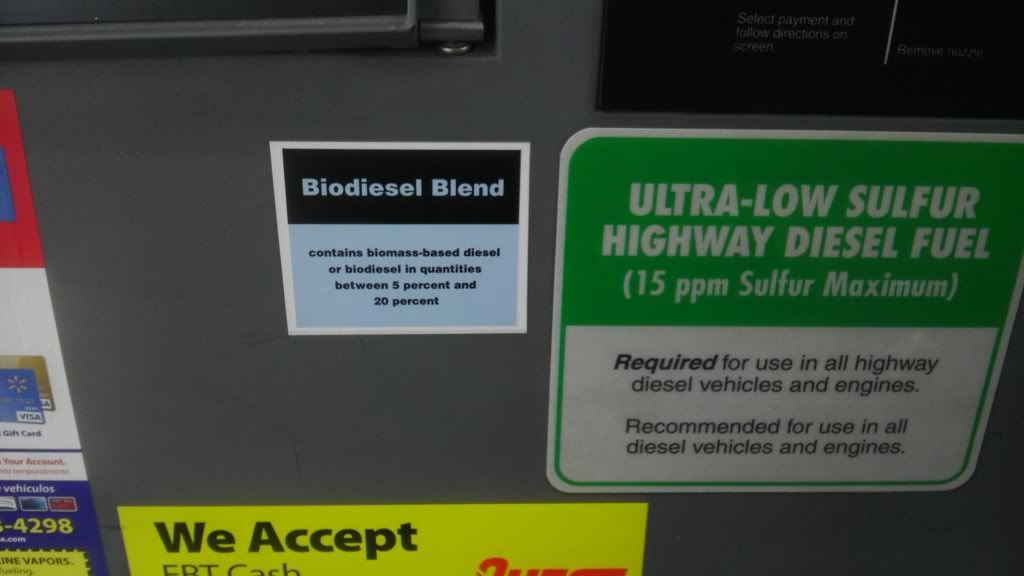

I was filling up Saturday at my regular Wal-Mart, and noticed this little sign on the pump

That's the good stuff.
It will keep your fuel system clean and your engine running smooth.

I love Bio, just a bit hard to find here. The place locally that carried it, and I trusted, was on the other side of town, and the pump seemed to be down all of the time. This was the first time that I had seen it a Wallyworld.

The OP doesn't say where he is, perhaps Illinois, which has most retailers pumping B11 for tax reasons. While this is a higher percentage than Jeep says to use with this engine, I've put enough miles on my CRD at blends up to B50 to know that B20 or less will not harm anything. Use it, that is indeed the good stuff.
