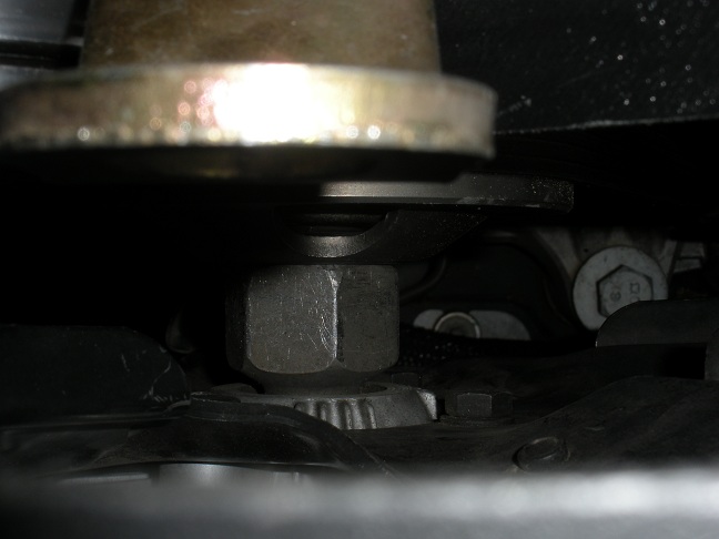

What size is the nut on the fan clutch?:

36 mm

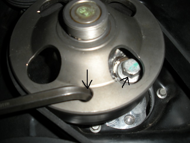

How is the allen wrench supposed to help stop the fan clutch? I'm putting one in the hole shown here, but it doesn't seem to have a catch point. What am I missing:

okay, never mind. I guess i just had to beat it with a hammer long enough.

Chuckle, it's certainly on there tight. I've used both the allen key trick and a deep socket set on that bolt head and held in place by a rachet handle. Once the fan base is held undoing the nut can require a certain degree of persuasion; in my case a Lisle fan clutch tool and an air hammer. A bit of anti-seize might help in future removal and by the way no particular need to torque the nut on reinstall; just run it down until it stops as normal operation will add any additional tightening needed if any.

I used a screwdriver to hold the clutch in place while I whacked on the wrench. That seemed to be just enough to loosen the nut. Haha.
