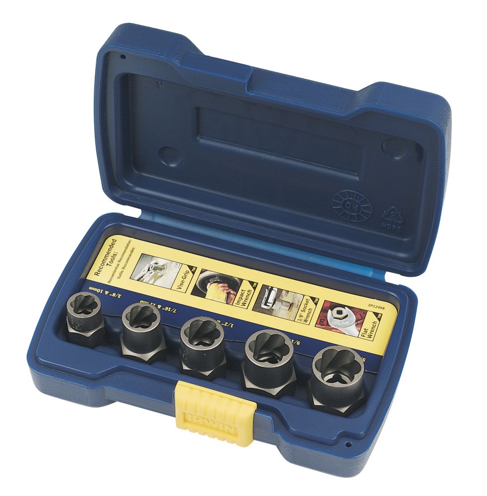

When I bought my Jeep, it had some goofy aftermarket wheels with these dumb "Gorilla" locking lug nuts (maybe someone stole the original wheels off it?). It needed brakes and as I was taking off the lug nuts, one of them snapped. I tried drilling, dremeling, chiseling, and bought some wheel lock removal tools. After several hours of messing around with it, I eventually lost patience and just drilled the snot out of the wheel. Then I went and bought a set of used OEM wheels from a junkyard and some normal lug nuts.
You may or may not have luck with a wheel lock removal tool. I didn't quite have enough lug nut left for it to grab on to before the tool bottomed out on the wheel. I tried drilling/demeling six notches in the remains of the nut for the tool's flutes to grab on to, which definitely helped, but I still couldn't get a good enough grip to turn the nut.

The fancy bolt removers like these just cut through the lug nut and you end up with a conical shaped mess still stuck on the rim. Image
