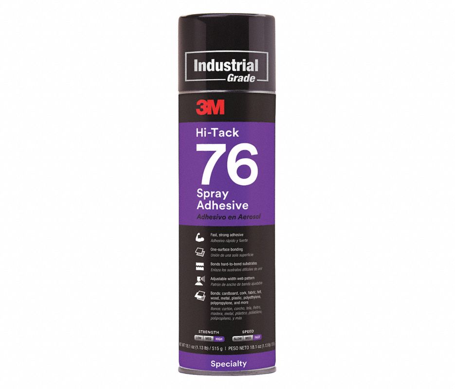

Had similar problem on my Dodge Cummins with 40 psig boost, had one connection point kept blowing off out of four.
Solved it by replacing all the rubber hoses with much better quality and thicker silicone hoses along with using new spring loaded constant force spring loaded "T" clamps and coating all mating surfaces real good with 3M spray High Tact 76 Glue. See picture.
Have not blowed a hose off since doing this!
If you still have rubber OEM boost hoses, get some good quality new silicone boost hoses like Samco.
As APC said, clean inside of hose and metal tube connection points real good with carb or brake cleaner (Acetone is even better) and sand or rough up the outside of metal pipe some.
Coat both mating surfaces with spray glue and use a good quality "T" type clamp. Tighten down until you see the hose start to very slightly "bulge" on both sides of the clamp. Allow it to dry for several hours or overnight before driving. It should solve your problem. :D
Note: Worm type screw clamps are not good clamps for boost hoses!

update, I have refitted the hoses, using the 3M glue. I happen to work for a generator company and have access to all types of clamps. in fact im a parts manger so I know them pretty well. that being said I am using a constant torque clamp not a t-bolt, we also carry silicone specific clamps with smooth band. I went with the CT because I think it will hold the best.
