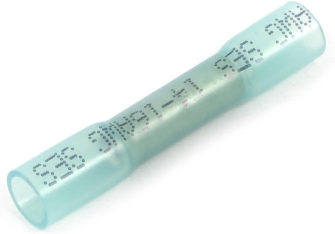

You can always open up a harness, locate the bad or damaged wires, cut the bad sections out and replace with new wires using heat sealed crimp on connectors.
Much, much cheaper and easier than trying to replace an entire wiring harness.
If you don't have a heat gun, you can use a common hair dryer on high to shrink and seal the connectors.
Done this many, many times over the years....

I have some of the connectors that contain solder inside of shrink wrap that are supposed to be used with hot air or propane etc but haven't used them yet . Depending on brand they have had mixed reviews think some can be crimped too .
Here is the best way I have found to twist the wires for use with shrink tuning works pretty good more reliable than wire ties . You could also use the push in connectors these work pretty well and you can put shrink wrap on whole connector mainly for insulation since one end not well sealed.

If you don't use heat sealing shrink crimp connectors and simply twist two wires together, you should always solder them together and then use heat shrink tubing to properly seal the connection.
If you don't seal up a connection, over time moisture can attack the connection and cause it to corrode and if that happens the high resistance in the connection can cause it to overheat and fail.
You would not believe the number of botched and improper wiring jobs I have had to cut completely out and totally redo correctly. :shock:
