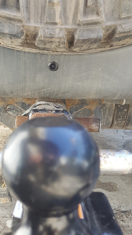

A bonus of the Pioneer 3500avh I just installed: back-up cam input. Along with installing the cam as a hitchguide, it would be cool to rig your trailer with L/R cam-feeds to monitor tires/bearings (though that would require a split-screen processor).

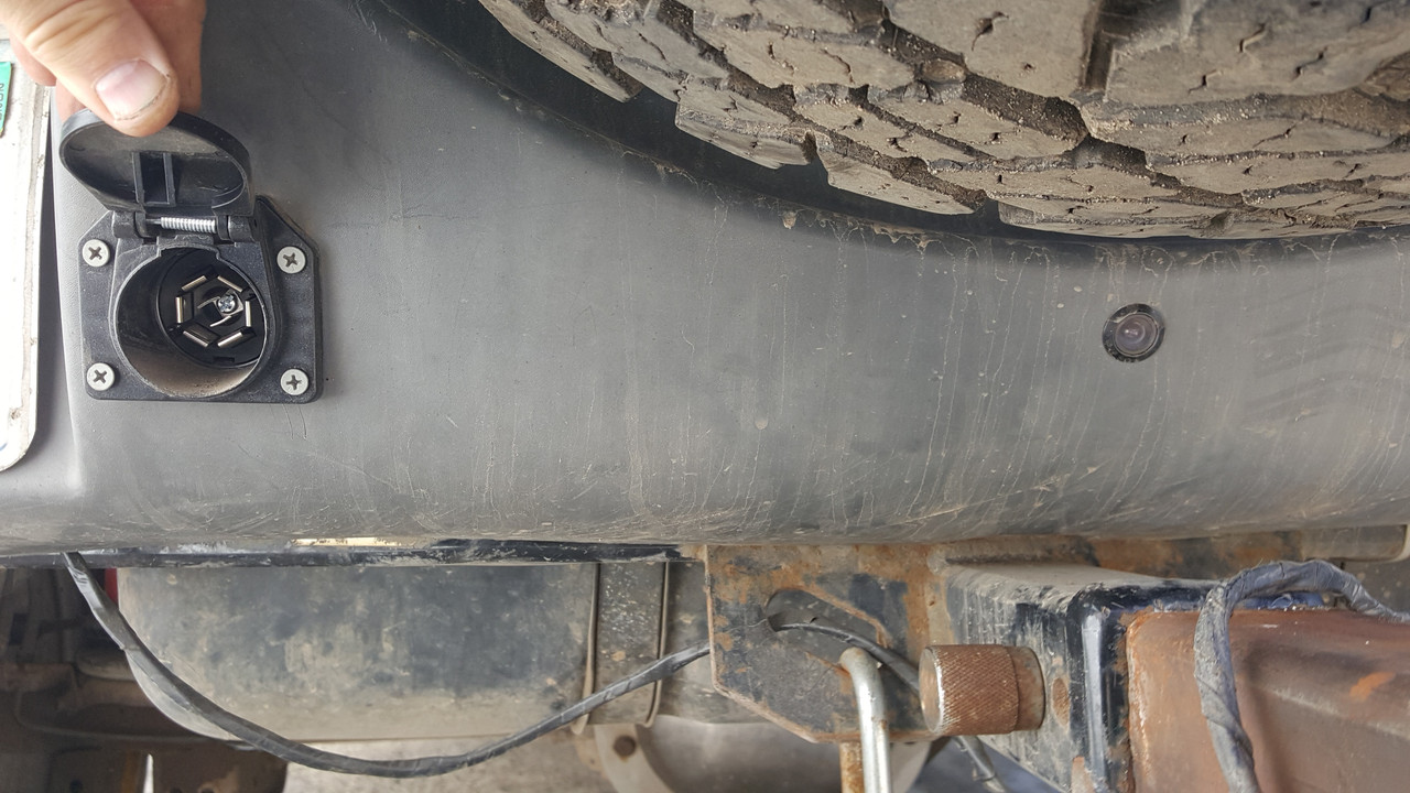

Towards short-haul heavy-towing & tractor-duty, I also installed a 7-spade connector w/brake controller & power supply:
<PICS DOWN 3 POSTS>

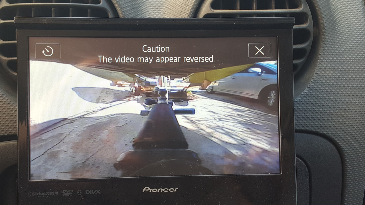

If you prefer the ability to view your cam/vid inputs with vehicle in motion, compatible head units require that you ground the feeds intended for the p-brake and "Park" switches.
Both Head Unit & Cam purchased during Nov. Consumer Sharknado:
@ Newegg: Pioneer AVH-3500NEX 7" 1-DIN DVD Receiver w/ Motorized Display $400. During install I barely bumped it's frail fn single rotary-knob, busted-off:$37! Maybe Crutchfield would've replaced it, but not newegg.
Camera@Bezos: RAAYOO L002. Waterproof? Fine question! Given intended for ext. mount, I'd assumed yes, but at $20 I may be in for some bad news next boat launch.
