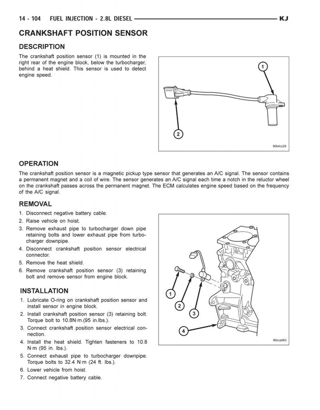

First recommendation, replace the crankshaft sensor if you have not already done so, they are known for going bad and not setting codes.
AutoZone (PN:SU8492) has a reboxed OEM Bosch sensor in their Duralast line, NAPA and several others also can provide sensor or it can be ordered online from IDParts or SasquatchParts

Crankshaft Position Sensor Information from FSM:
